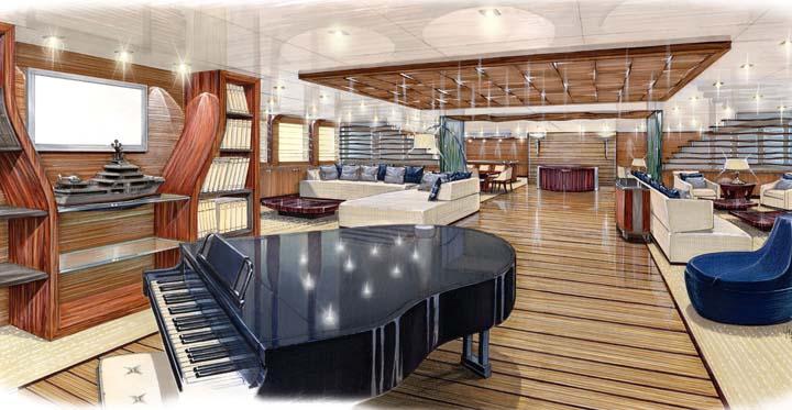

  3. True to the Palmer Johnson identity, Italian designers Nuvolari-Lenard have ensured the six-deck interior and exterior living areas provide the highest degree of comfort. Focusing on well-being, healthy living and relaxation, large open spaces are emphasized and extensive panoramic sea views create an open environment for ocean voyages.

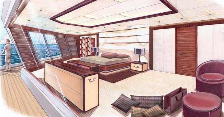

  4. The owner’s apartment is situated on the fourth, fifth and sixth decks comprising of bedroom suite, walk-in dressing room, separate business and private lounges, office and a Jacuzzi sundeck with 360 degree viewing.
