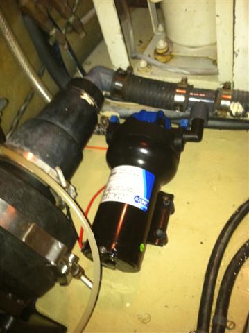

    I replaced the (very) old pump configuration (12 and 110volt) with a Flojet High Volume Water Pressure System,
    see: Flojet - High Volume Water Pressure System
    A placed it at the location of the 110 volt pump set, at the left rear of the port engine, to get more freedom of movement in front of the engine.

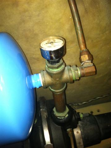

    I asked this same thing to and got all kinds of interesting feedback:
    http://www.yachtforums.com/forums/post-yacht/18364-adding-12v-fresh-water-pump.html
    Easy project I did last winter. I found the T fitting online from a landscape irrigation vendor. Parts used for underground lawn sprinklers. I pulled out the pressure gauge and put the pump output into that with a hose barb fitting. Has worked great. I didn't get involved with shut off valves and isolating this pump - I'm not away at sea for days where this would be good to have.
    I was surprised to find the pressure much better with the 12V than the 110. I tend to use only the 12V now. Great when anchoring like you mentioned.
