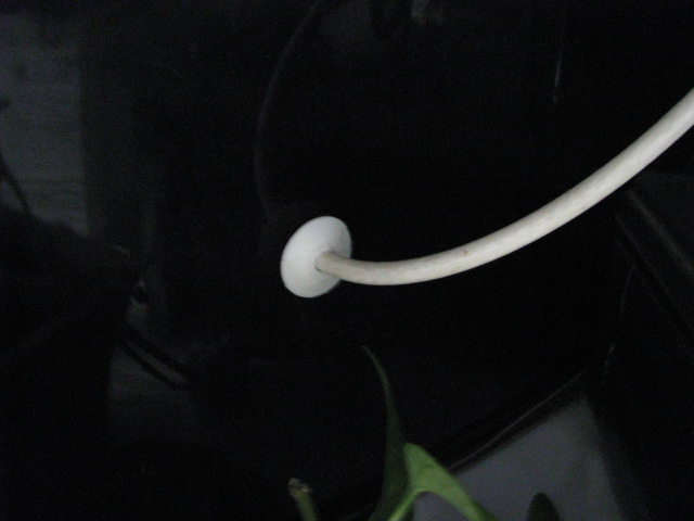

    Sounds like you may be heading toward cutting a 2" hole and installing whatever (shower head recessed deal?) to cover up a 1/4" tube. With something like this it's clean, neat and you can just slide the tube back through when not in use. IMG_2581.JPG

    I wasn't worried about the 2" hole, I really wanted to keep the look cleaner when the ice maker wasn't on the deck. Your white grommet is clean and I think that's what I will put inside the recessed fitting. Slide the hose back in when not in use, and if it's deep enough, I can put the 1/4 turn shut off in there as well.
    I like this too, if I can find a smaller box than the standard shower sprayer setup. I especially like the coiled spray hose thought.
