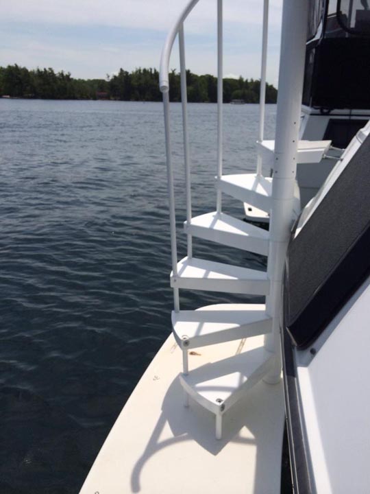

    Now that I have the spiral stairs installed, I have real difficult stains from where the old ladders used to be.
    Some of it looks like rust but some looks like stains from the teak.
    I've tried a few products Starbrite non-skid, West Marine deck cleaner etc.
    I was thinking of rubbing compound, but I'm not sure about using it on the non-skid.
    Any thoughts?
    You can see it through the 1st & 2nd stair.

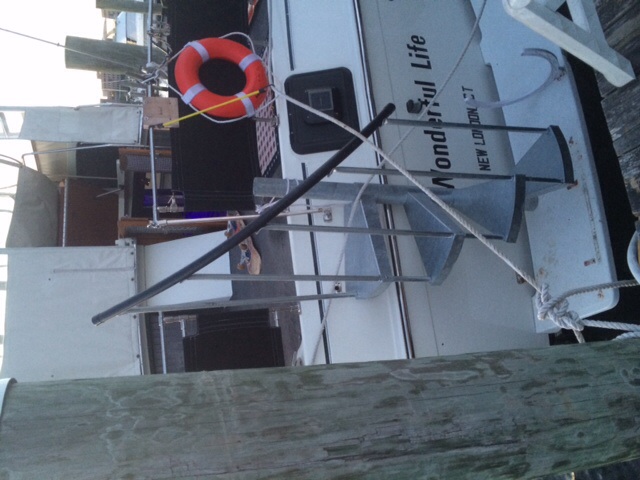

    Spiral stairs
    Looks like she did a great job on yours
    Here are mine

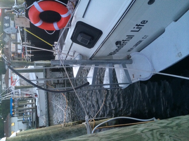

    Stairs
    These are not finished in the picture but what a great fit
