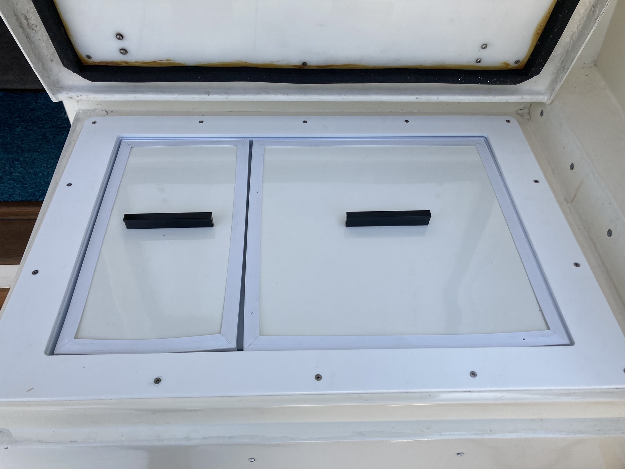

    What do you use to hold the cockpit refrigerator cover open when accessing inside? Haven't thought of a solution. We have a vertical load refrigerator in ours which has it's own insulated covers. Can't hold the fiberglass cover up, the interior cover and and still have a hand to get at the contents ;)

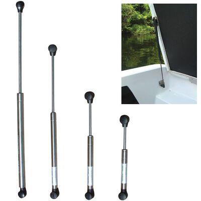

    Is this a flopping fish box or a real freezer for packages?
    Hatch holders that use springs work well.
    Or maybe Gas-springs.
    Installed under the cover on the right side.

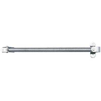

    I have the folding spring type for my cockpit freezer. Problem is the covers are heavy. If you bump the spring reaching in, the lid crashes down on you and hurts like like a sum bit-h

    I also have the folding spring on my cockpit freezer, but it is a heavier duty spring that is hard to bump. Works well enough.

    I looked at a couple of the folding springs. Need to see if the cover interior thickness/height is enough for the spring to 'fold'.

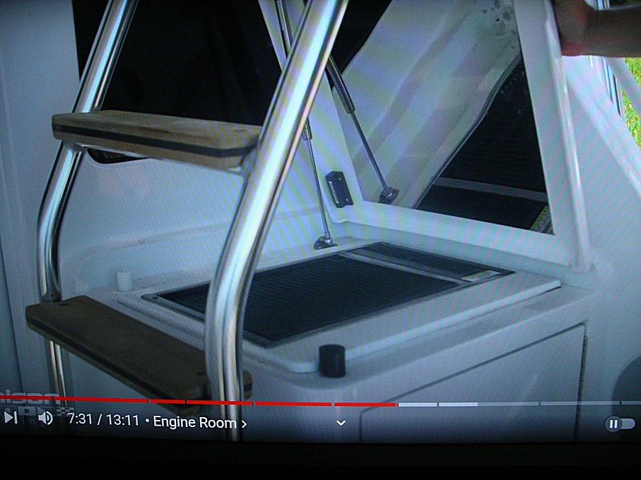

    I have the same cockpit refrigerator/freezer but mine doesn't have the internal lids, only the insulated hinged lid. Mine has a folding hatch support mounted internally on the starboard side, and yes if you bump it you'd better be ready to grab the lid or get out of the way quickly. BTW Frigibar still has all the cooling apparatus for these old units at a fair price for everything except the compressor.

    I removed the old cold plate unit and remote compressor. Current is an Isotherm bi-75 self contained unit. I had a new cover plate made to match the original box outline and adapt to the new refrigerator opening.

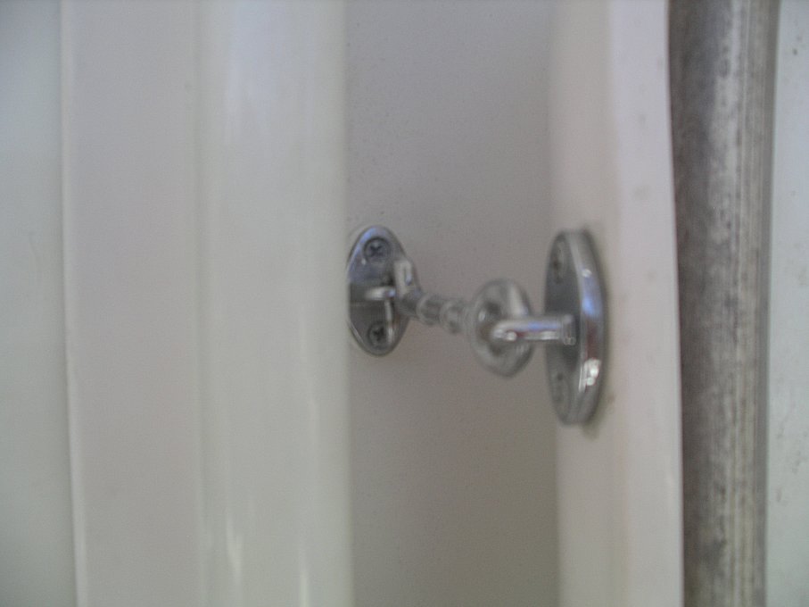

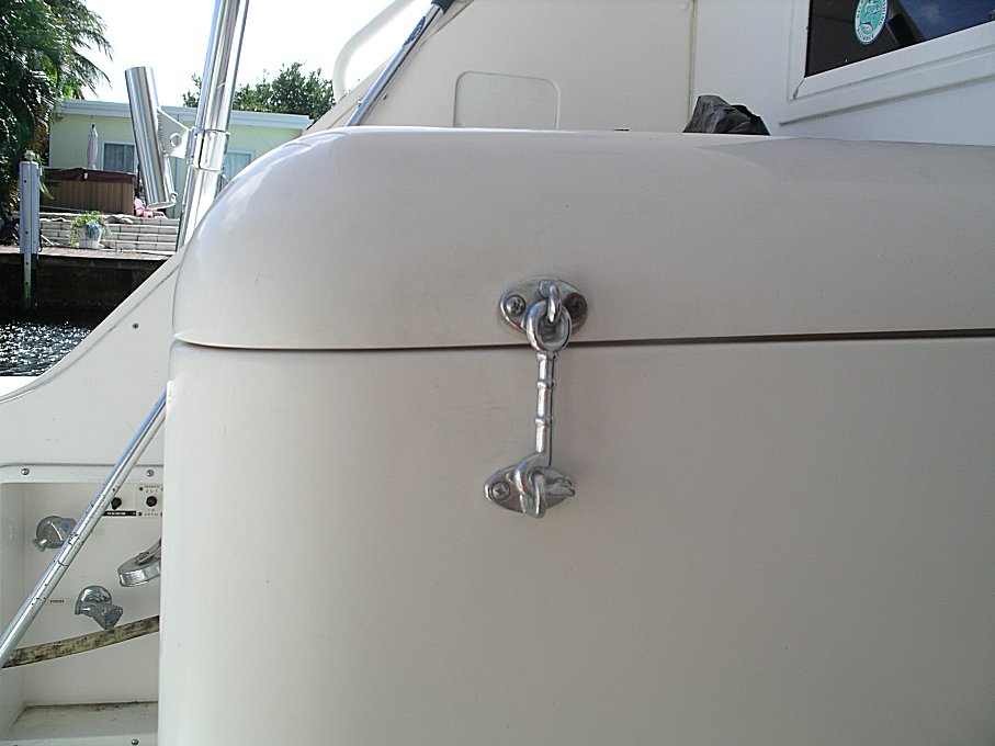

  11. SplashFl
    SplashFl Senior Member
    Feb 2, 2021
    605
    S. Florida _ Bertram 46

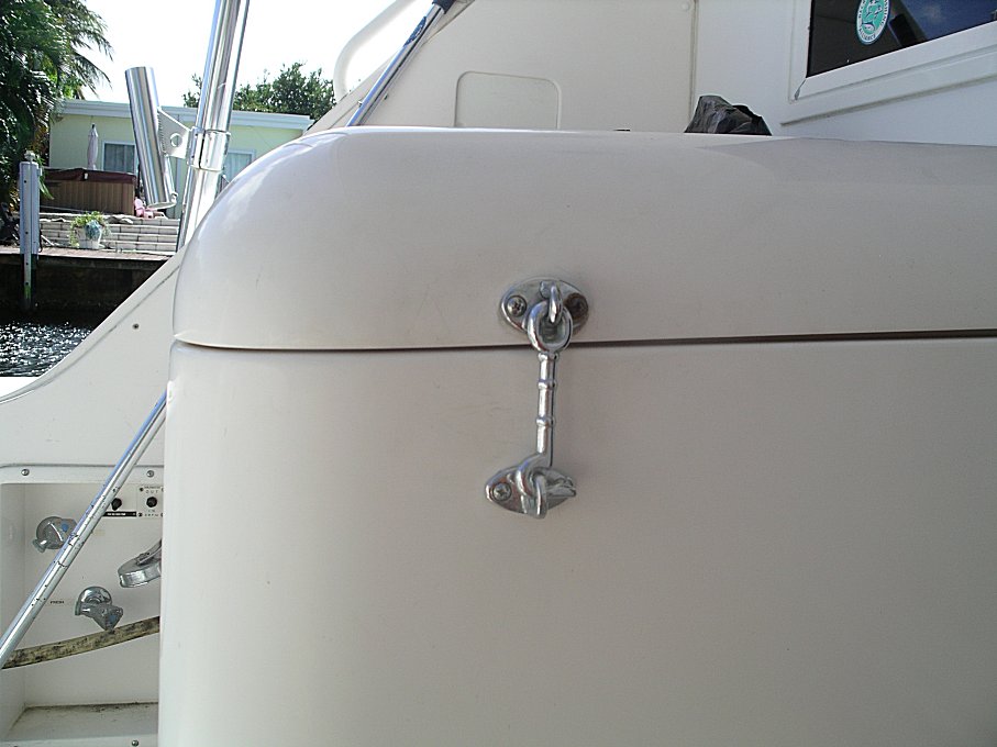

    Bertram OEM:
    Greg Page likes this.

  14. Greg Page
    Greg Page Senior Member
    Mar 4, 2017
    456
    Annapolis MD
    Thanks. Have been away on the boat for several days.

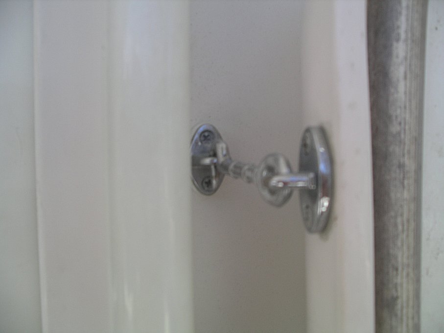

    I thought of a hook but didn't look at mounting on the side. I'll have to see where that would put the receiver piece on the back cabin wall.
