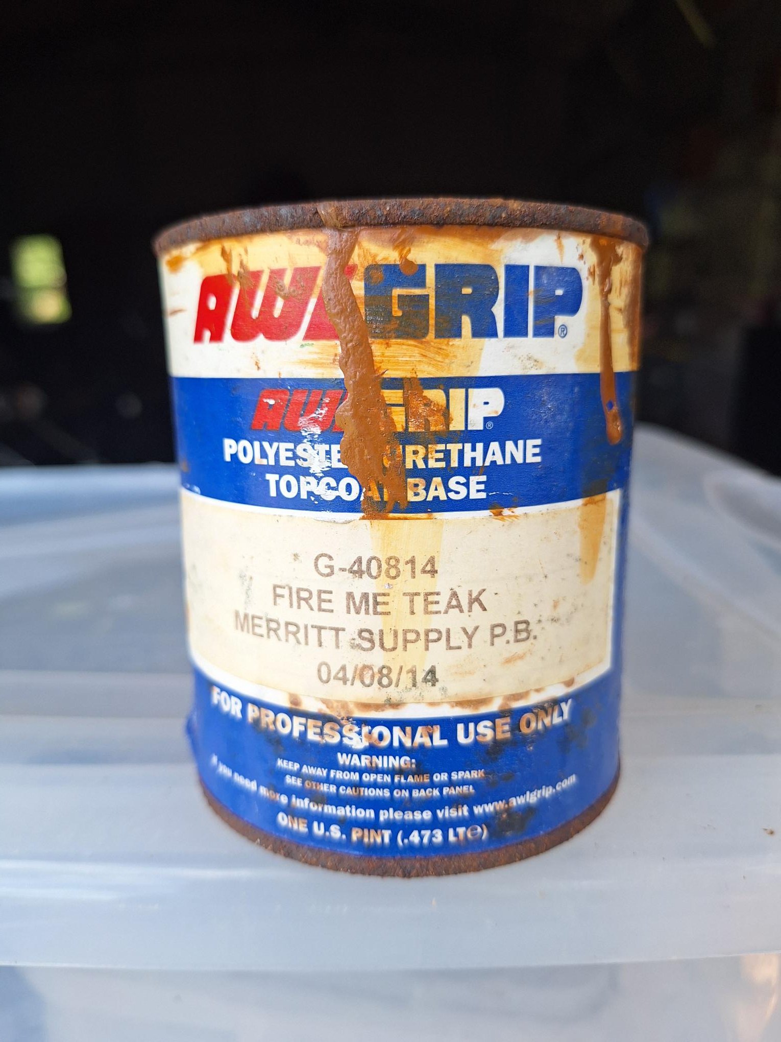

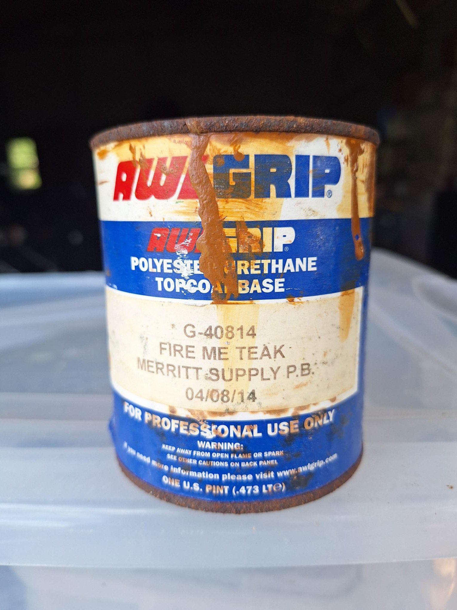

    Yes. Several years ago I wanted to paint a teak stripe across the front of the boat where your teak is mounted.
    I worked with the paint Master at Merritt Supply in Pompano Beach to develop an Awlgrip color. After burning through a few pints of different colors we came up with a perfect match. The paint Master asked me if I wanted to establish an official Awlgrip color for my new teak paint and I said yes, somebody else might want to do this someday. The paint is now an official all grip color that can be brushed or sprayed on. It is called "fireme teak". Anyone can order it because the mix is recorded. I called it fire me because if I didn't get it right my wife would fire me from the paint job. I still have the can if you need a picture or more information on how to get that color.
    Fire Me Teak Awlgrip
