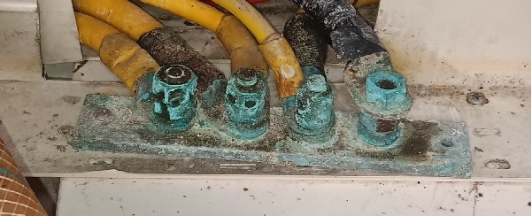

    I have been involved with similar issues on DDEC boats lately (so much for retirement)...
    All the equipment comes down to a common (or two) negative buss bars.
    You may find these common bars loose, pitted from over amping or green enough to start another life form.
    If you truly have, or think you have, separate banks for everything, this may be a great suspect area to look at soon.

  7. Capt Ralph
    13,889
    It has been a season of ugly connections.
    Here is a better picture from last December from my new best friends boat.
    Just a lil patinia. That 3rd stud was loose.
    Since then, I have witnessed buss bars with green shrubbery growing from them.
    Sorry I have no pictures of them.
    From a bar like this, controls from the helm, options from all over the boat, battery charger with one common negative lead, ECUs and heavy loads (engine starters & thrusters) may not have a chance.
