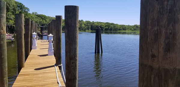

  11. Capt Ralph
    13,888

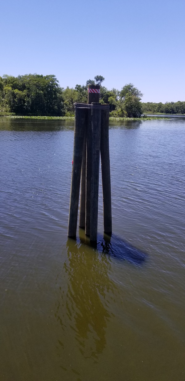

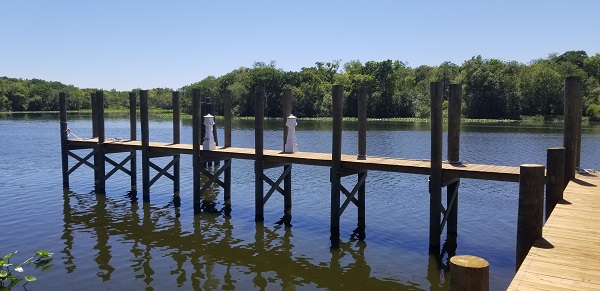

    Here we go. Found some pictures here on the boat computer.
    Yep, built April 2019

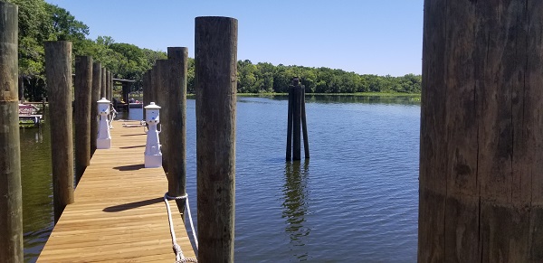

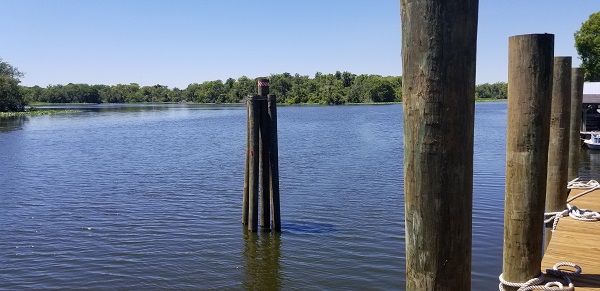

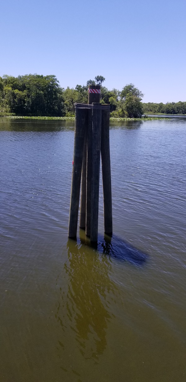

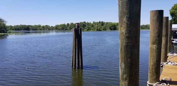

  12. Capt Ralph
    13,888
    Scary to think of it this way; The dock has already paid for itself within 40 months.
    Oh, one of my specs was not correct, its 80 feet long.
    These dolphins are not going anywhere.

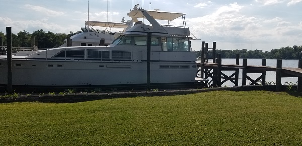

  15. Capt Ralph
    13,888
    Savings in paying dock rent at the Jax marinas.
    For the two boats, slip was $2500 a month. Way more now.
    Then commercial rate electricity.
    Free standing. Offers some strain in keeping the boat off of the dock during ugly weather.
    Those are 5 pole dolphins. One surrounded by 4. On the outside of the dock ends.
    The inside slip has two single pole dolphins and a few mobile home anchors set well in the yard, another 20 feet away.
    I've done a long dock at a previous house. The marinas in Jax luv long docks also.
    I'm getting to old for long hikes.
    This picture shows it is not a long walk on the dock and,,
    When I took this picture, I was standing on our house's back steps.
    Dark horse likes this.

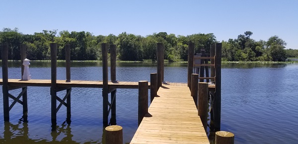

  16. Capt Ralph
    13,888
    The above pic also shows a good point of laying on the inside of the L (or T).
    Passing wakes push you aweigh from the dock vs on it.
    The local bass & pontoon boats don't offer the bad wake as in Jax,
    but every now & then, some swamp head does come by with the mother-in-law planted in the stern and bow pointing to Mars,,
    Still as other places,, with out a clue what he is doing (other than dating the mother-in-law while wife is working).
