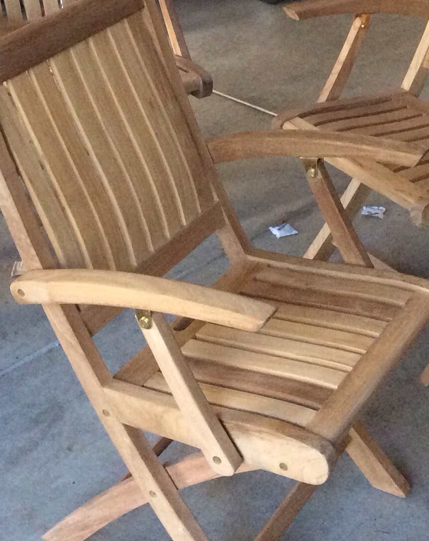

    Just got these 6 teak deck chairs. Table is being built in high gloss. Would like to varnish or equiv these also. Looking for recommendations on system and whether to spray or brush.
    This is a project I'll do myself. With hplv gun or pressure pot.
    There are a lot of tough to get to angles and These chairs fold. I'm not excited about have to disassemble. Suggestions?

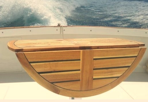

    Did no chairs, but a foldable garden table conversion and used Epifanes varnish (brushed 6 layers), to give it more of a ‘boat look’!

    My marine carpenter/finisher uses 2 coats of west system no stain, followed by 6-8 thin coats of clear Epihanes. If you want a "mirror", follow with 1000 grit, #4 pumice stone in lemon oil, then rotten stone in lemon oil. You can do less of course.
    Oil and polish is another option. Methodology is all over the net.
    You can also keep them natural by regularly washing them with a mixture of bleach and water for a faded teak look, but no gray
    Oil is less forgiving on you back if you don't keep up with maintenance. Varnish, well we all know about that....

    Your forgetting something; You coat those chars and you (and others) will be SLIDING out of them. That bare wood holds you in place.
    Slip Slide comes to mind.

    So what does the west system do? Just a stronger base coat?

    If they were my chairs, I'd oil them and be done with it..just remember teak is a very soft wood, so when you do wash them scrub (lightly) across the grain. If you go with the grain, eventually you'll wear out the soft parts and will result in razor sharp ridges.

    We use Teak Wonder on ours, they look great and hold up well, once a year we give a good scrub with soap and a 3m pad then reapply TW. Half way thru the season we give them another coat.
    The varnishing will take you a long time, and unless you are really good at it, your end product might not be so nice. I must say a set of varnished chairs do look outstanding!

    stronger base, excellent sealer particularly on the end grains and good build. You probably don't want to use the epoxy if you are not going to polish and get that 'glass' finish. Another thing you may want to do is put some rubber dibble feet on the chairs to keep them out of any surface water on the deck - that's usually all end grain and will soak up a lot of water.
    Another solution is a combination application. Oil the slats and legs, varnish the arms, sides, head and seat piece. You will probably use cushions over the slats anyway.
    Nice looking chairs, BTW. Let them have some sun for a couple of weeks/months and the teak wood colors begins to look more uniform.

    We have folding teak chairs that stay inside and they are spray varnished/finished. We have some that go outside on deck and they are kept natural/unfinished. The unfinished chairs are used with a high gloss teak table and they are kept covered or stored inside when the boat is not in use.

    Any finish you apply like a varnish or polyurethane will have real problems anywhere that nice bronze hardware penetrates. You will never be able to seal it, and once water gets in under the coating you will be sorry. I use Amazon One Step Teak Cleaner once a year on chairs like these, with mild (white) 3M doodlebug pads. Leave them natural.

    If you want the full on high gloss deep clear coat look, nothing seems to beat clear epoxy base coats followed by multiple coats of clear poly like Awlgrip. It also makes for one of, if not the, longest lasting finishes.

    I'm going to leave natural. We got the chairs at Java teak outdoor furniture dot com. Was worried about quality and then found out they were local. Sourced from Indonesia. They seem to be really solid and beefy and unit $200 per. A little tightening was needed, but pleased so far.
