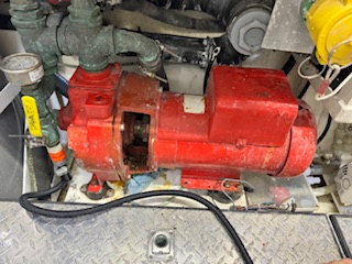

    How often do you guys test your sea water fire pumps? It doesn’t get tested during the annual fire system inspection.
    I ve been hitting the switch once a month or so just to make sure the motor runs but only fully test it every 12-18 months. Pita to have to flush and then dry the hoses etc.
    tested it last week and nothing, zero pressure. Pulled it out (Mr Pump HLLF) and found the bronze impeller spin loosely on the threaded shaft.
    Just got the parts from Depco.
    I guess I should test it more often :). Also replaced both fire hose (aft deck stairs and bow)
