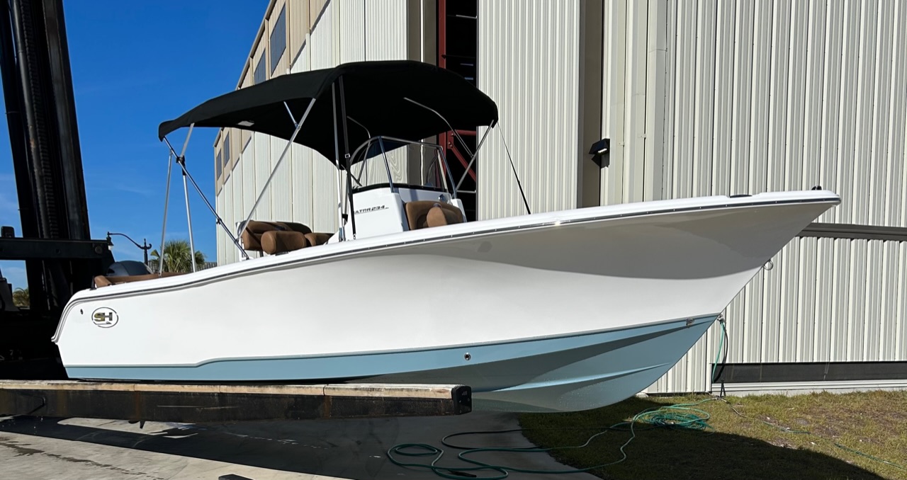

    Yeah, agree: Looked closely at a new Scout a few months ago, but decided on the competition instead and glad I did, saved 4ok and this thing works just as good. IMG_4665.jpeg
