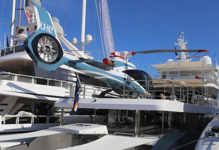

    I am a new member and am looking for any info involving helicopter operations on yachts. The helo I maintain is on board for 2-3 months during the summer only. Otherwise it is at our home base. The environment is way more severe on board. I am always looking for tips and helps which my fellow technicians have experienced. Thanks in advance.
    Airbus H130 on board a
    Fedship 70 meter

    On-ship operation of a helicopter requires a lot of professionalism. And this both from the flying point of view and from the on-board parking and maintanance aspects. I assume, You are familiar with the additional maintenance items, when operating a helicopter in salty enviroment, especially on a yacht. One point, that is often forgotten or not done because of the trouble associated with it, is the engine conservation run at regular intervals. During this conservation run, a special oil is sprayed into the engine intake, while rotating the engine or on some engines even with running them on ground idle. This run also includes cleaning the oil and fuel system also.
    As I can see, on this 70 meter Feadship, the H-130 has no hangar, when parked on board. I hope, You have enough covers for all critical items, like Engine intake, engine exhaust, the rotor head, especially, when the blades are folded and most of all the fenestron tail rotor. The whole tail should be covered. If the helicopter is stored without folding the blades, the blades should have a solid support, not only a tie down, like on normal on-land operation.
    This landing spot for example is in my opinion to far to small and would be illegal for a charter yacht. And the Fenestron is totally unprotected. Tying down the blade tips under tension does not prevent their swinging and vibration. This H-130 on the picture above will suffer a lot from the ship operation and he is very prone to damage during its operation

    Just to clarify, the pic included was for show only. Often, when the ship is docked and weather is good enough to fly, the owner likes the helo uncovered, and visible to passerbys. If the weather turns bad, of if we are under way, the complete helo is covered with a Bruce's cover. Unfortunately, it is a monumental task to run the helo onboard, except to fly it when requested. If we know it will sit a while we do a motor and compressor spray only. It is also at least rinsed every day. When we are doing a crossing, I come out to the yacht during departure and arrival to pull and install the blades. we have a water tight blade storage box on deck.

    Removing the blades for crossings and storing them in a watertight box is absolutely perfect, when storing the H-130 on the open top deck. But salty humidity is the worst enviroment a civil helicopter can sit in. I would also tape off the doors and place some dehumidification boxes in the interior. Daily rinsing is also a very good idea.

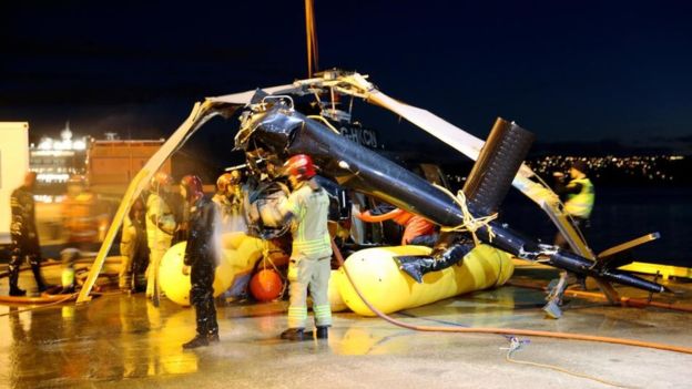

    A few years ago a helicopter tried to land on a yacht in Bergen, Norway after the deck crew had left a loose tarpaulin close to the landing platform, the rotor wash sucked it into the rotor and it was almost total loos of control, but the very experienced pilot managed to tilt the craft, or rudder turn it so it fell in the ocean rather than on the boat to avoid a fire after the crash.
    Moral of the story, clear the landing area of any loose debris before the helicopter starts the approach.
