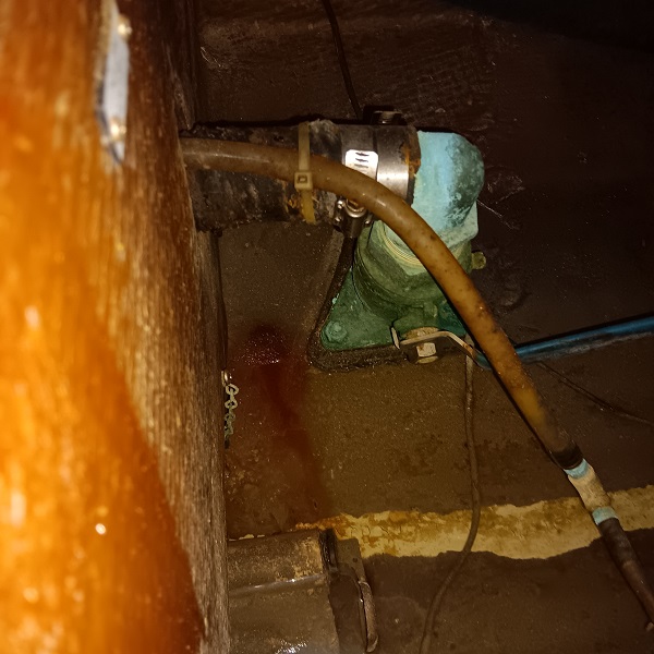

  5. Capt Ralph
    13,889
    Nothing in my pictures.
    My pictures do not include the starboard end of the black water tank.
    Viewable under the last deck plate aft, center-line, by the galley.
    I do not recall anything there or I would have a picture of it.
    I found my notes. No black pump mentioned here either. Just the sea-cocks and hoses.
    I do think it is a gravity drained tank. Straight down thru that 1 1/2" sea-cock, that was stuck closed.

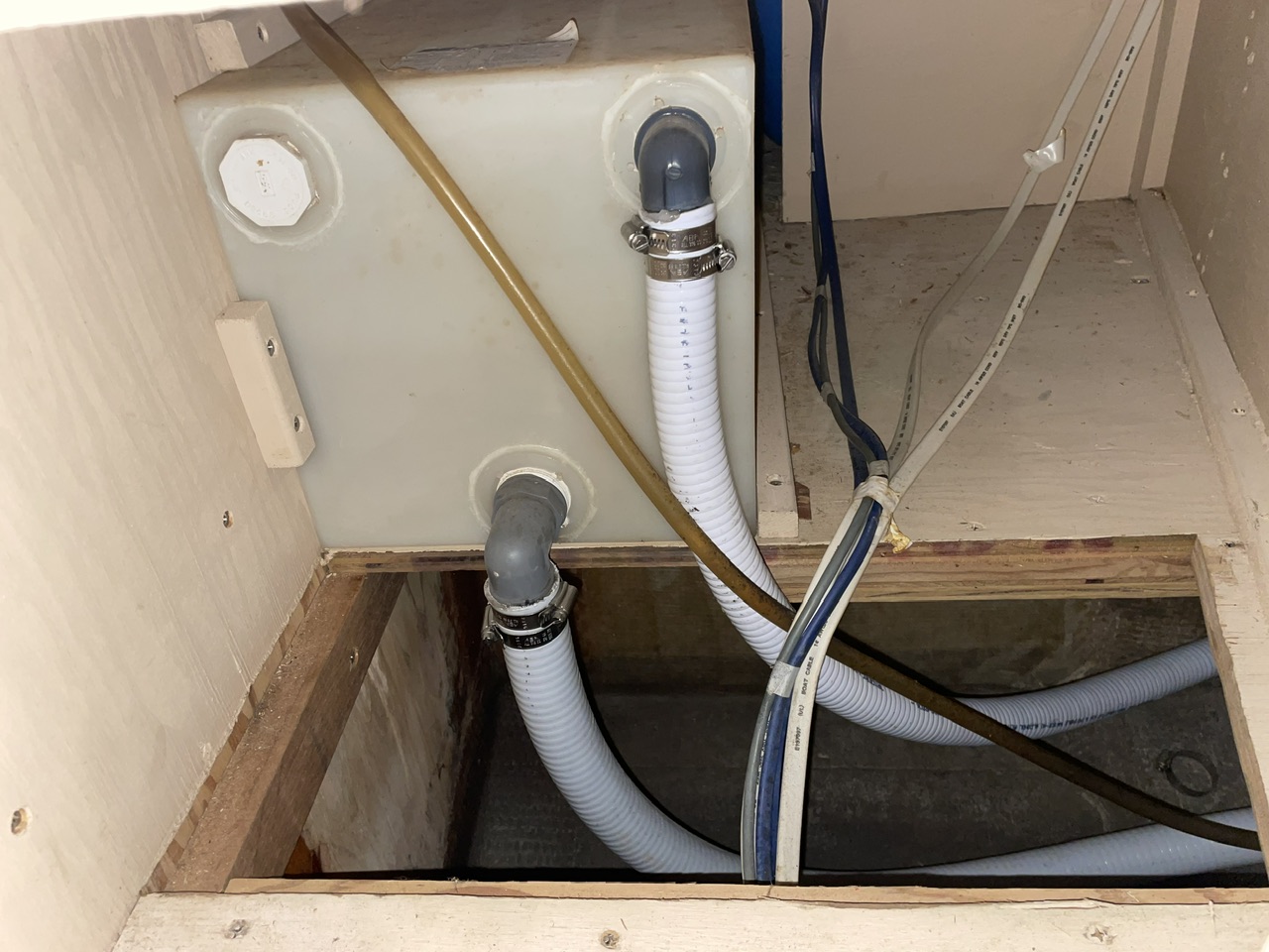

  6. incoming
    incoming Active Member
    Jan 14, 2021
    196
    Cocoa Beach, FL
    Here’s a pic
  7. Capt Ralph
    13,889
    Uh Oh,,,, That is not white hose going to that sea cock.
    I missed that.
    Where The Frack* does that bottom white hose go??
    Please forgive me brother, I may have messed up.
    *Another WTF episode...

  9. incoming
    Jan 14, 2021
    196
    Cocoa Beach, FL
    the bottom white hose goes to the stuck seacock, which is forward of the companionway stairs under the floor, near where the seacocks are for the overboard flush and raw water head intake. Same seacock I believe your photo is of

  16. incoming
    Jan 14, 2021
    196
    Cocoa Beach, FL
    The hose is now new - but unfortunately the seacock still stuck closed. I could put my pvc pipe “breaker bar” on the handle and give it a tug…or just wait until next haul out

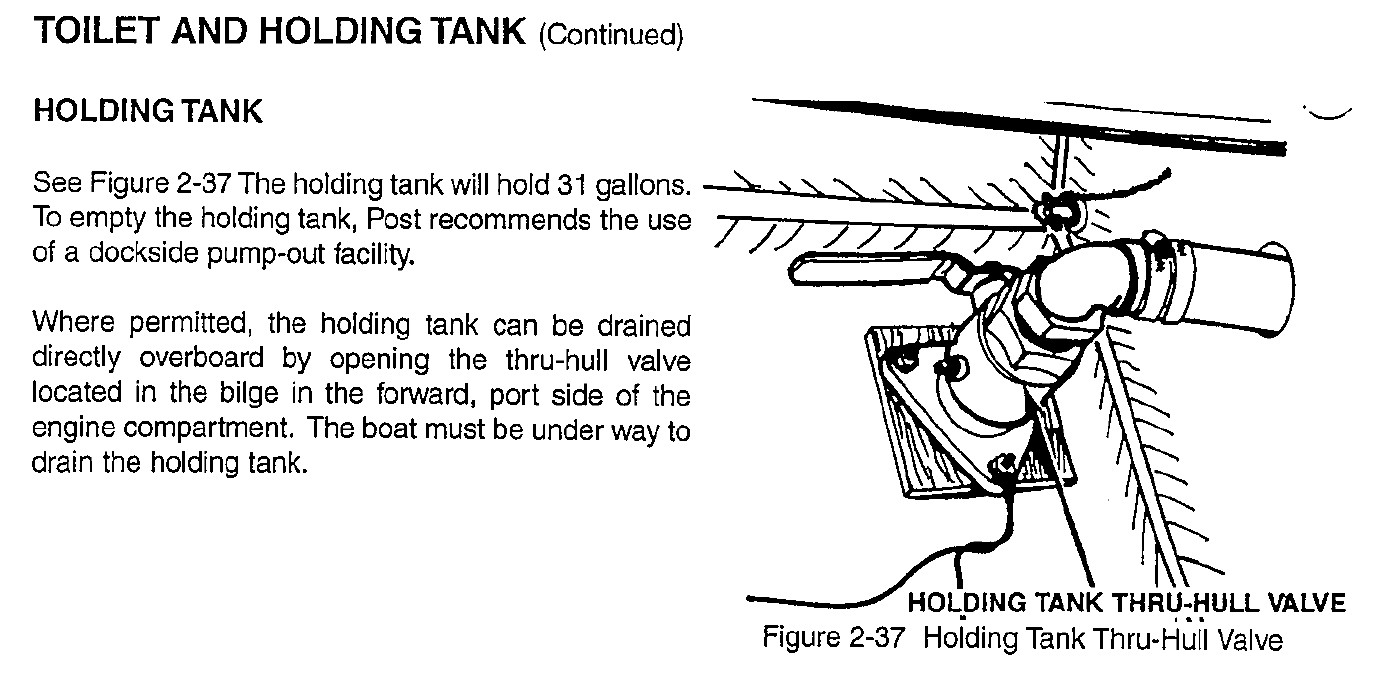

  20. Greg Page
    Greg Page Senior Member
    Mar 4, 2017
    456
    Annapolis MD
    I knew I had seen the holding tank empty procedure somewhere. It is on page II-26 of the 42 Post owners manual. PM me if you want an electronic copy.
