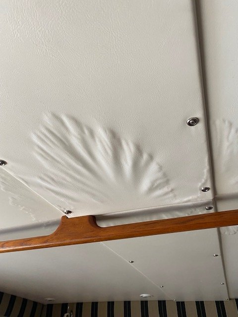

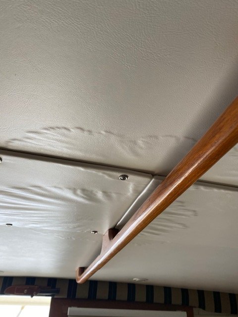

    I had the helm pump rebuilt last season, after install a fitting was leaking a little, through the access under the console into the vinyl of the headliner. There's no discoloration but the pics tell the story. I've already stuffed absorbent up under it but the oil has seeped into the material. Replacement would involve at least 4 new sections. Any ideas? Would heat be able to dissipate/evaporate it or is the material shot?

    The latter, I'm afraid.
  3. Capt Ralph
    13,889
    How screwed is my vinyl headliner?
    It's toast.

  6. Capt Ralph
    13,889
    You need something to glue to.
    That damaged headliner is de-laminating and falling apart, 100 years ahead of schedule.

  8. Pascal
    8,739
    It s done. The foam backing has separated from the vinyl
    If you can match the vinyl, it s not a big job. Just pull the panels, strip, spray headliner glue, attach the vinyl and staple on the back side.

  9. Stainless45
    Stainless45 Active Member
    Jul 19, 2019
    168
    Post 46 Long Island NY
    The headliner is entirely made of thin vinyl, no foam backing. It is "suspended" attached to wooden battens that it hangs from, if that makes sense. It has 'give' to it in between the frames that support it. Unfortunately multiple large pieces are sewn end to end and of course the damage is right in the #%@% middle
  10. Capt Ralph
    13,889
    Foam backing may not have the correct term, think cloth with a synthetic (vinyl like) laminate. The steering fluid has destroyed the adheadsion between the two.
