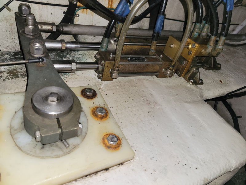

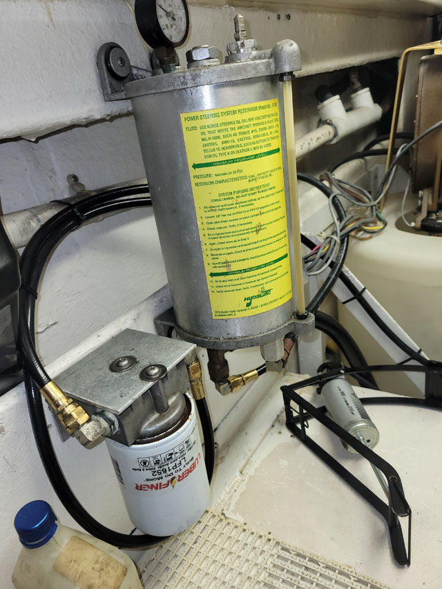

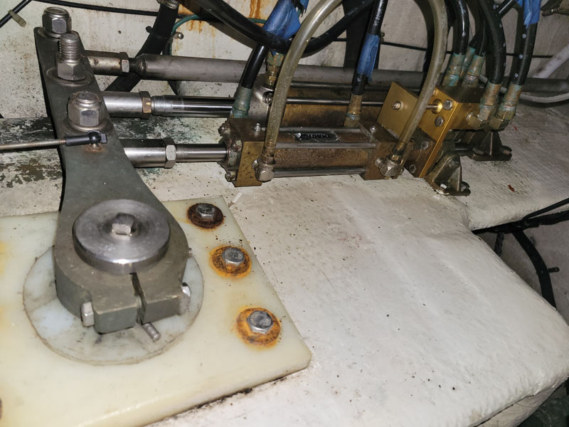

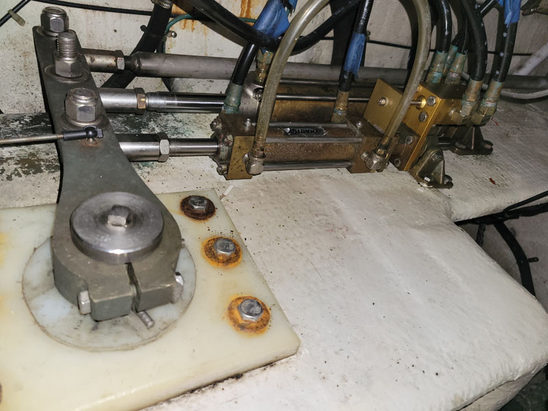

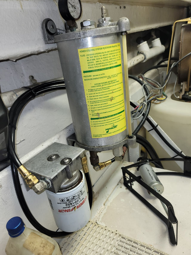

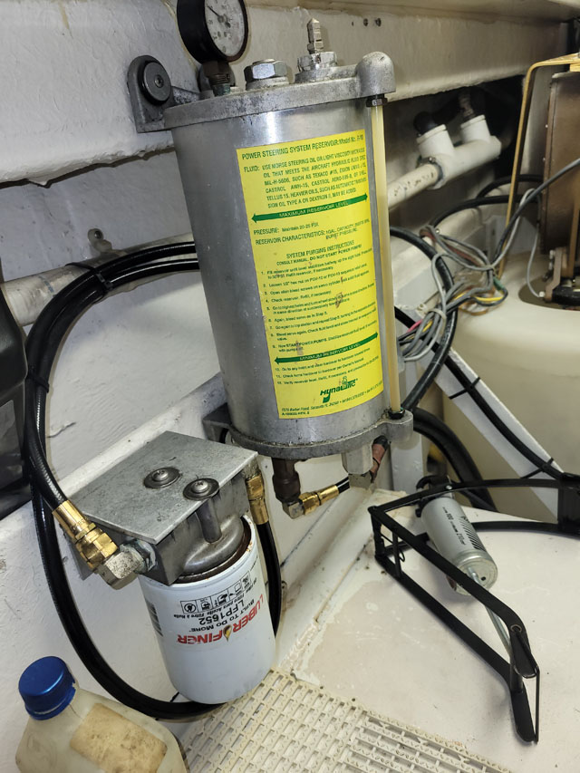

    Hydraulic steering issues Ocean Yacht.jpg Hydraulic steering issues Ocean Yachts2.jpg Does your steering system look like this?
  18. SplashFl
    SplashFl Senior Member
    Feb 2, 2021
    604
    S. Florida _ Bertram 46
    Yes. The steering filter is definitely under pressure. No plans to mess with the steering but it's about time to get the controls as I believe they should be.
