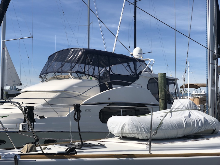

    Is it better to leave isinglass open or closed on a boat in a storm? I have a 47-footer with the entire upper deck covered with 2-year-old isinglass.

    Based on the projected wind speed for Northern Palm Beach County, I would leave the isinglass up. If we were closer to the eye-wall, take it down.

    I hate countering with da boss, But if it was my boat, all would come down, including the canvas.
    The first question from your insurance company will be; Why did you not take it down??

    Anything over designed wind/ship speed.
    Bottom line, In my opinion; When in doubt, take it down.
    Even if I'm wrong, you always can put it back up.

    I have the polycarbonate and it has been fine staying in place for winds to 70mph. I would prefer to leave it up provided I believe the wind won’t exceed 70mph or so. That way I keep some/most of the wind driven rain out. I don’t have experience with the isenglass that can be rolled up. Based on the forecast for Rivera Beach I believe you would be better leaving it up and keeping the rain out. I have a named storm deductible so I will pay for it if I lose my enclosure. I have a hardtop and a windshield. So I don’t know if the soft tops make the entire enclosure more prone to failure. Hopefully some one else will have thoughts on that. Good luck.

    over 45 mph I'd remove it.

    Down here in miami I removed my Bimini even though forecast is just 30-35kts.
    problem with these storms is that you will get embedded squalls in the feeder bands with much higher wind for a short time.
    palm beach will get a little more wind than us, probably 40-45kts. Why take a chance ?

    As others have said, I'd take it down... and fold/strap the bimini down too. Add the bimini cover, if you have one. And then cover helm instruments and so forth as best you can with something waterproof and completely taped down.
    I might think differently if you had hardtop and rigid enclosure panels, but it doesn't take much of a wind sometimes to get inside a soft enclosure... and with winds predicted at/near 74+ MPH, you would just be gambling otherwise.
