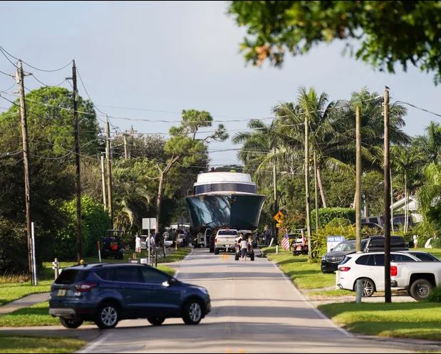

    109' and yes, Jim Smith is about a mile from the water and always have trucked them to the Hinckley yard I think it is to be launched, also need to get the power company out to remove power wires in order to do so. For the 2-3 yachts they build a year, it seems to work for them and has for decades. Jim Smith also builds a few smaller yachts that don't need all the fan fare which the article doesn't state.

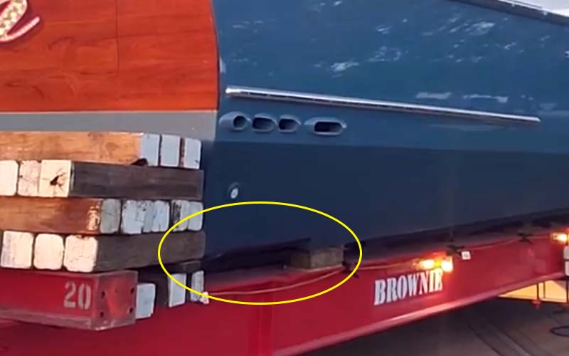

    Do you guys have an idea of how the stern section of the hull is made, and why?
    The detail below from the video in the linked webpage made me curious...

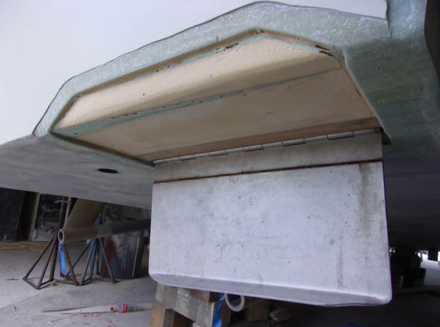

    It's most likely where the recessed trim tabs will be mounted, obviously once it's off of the trailer.

    I can see why recessed trim tabs make sense on a SF, to minimize chances of interference with fishing lines.

    That's where mine are on my sportfish and where are the exhaust ports on the stern? Recessed tabs are directly behind the wheels, not far to port and starboard. Mine don't have openings to the side just facing to the aft but I assume this vessel has 2600 hp mtu. Those engines need to breathe and the fiberglass box under the deck that forms the exhaust would interfere with tabs and rudder if only discharging toward the stern.

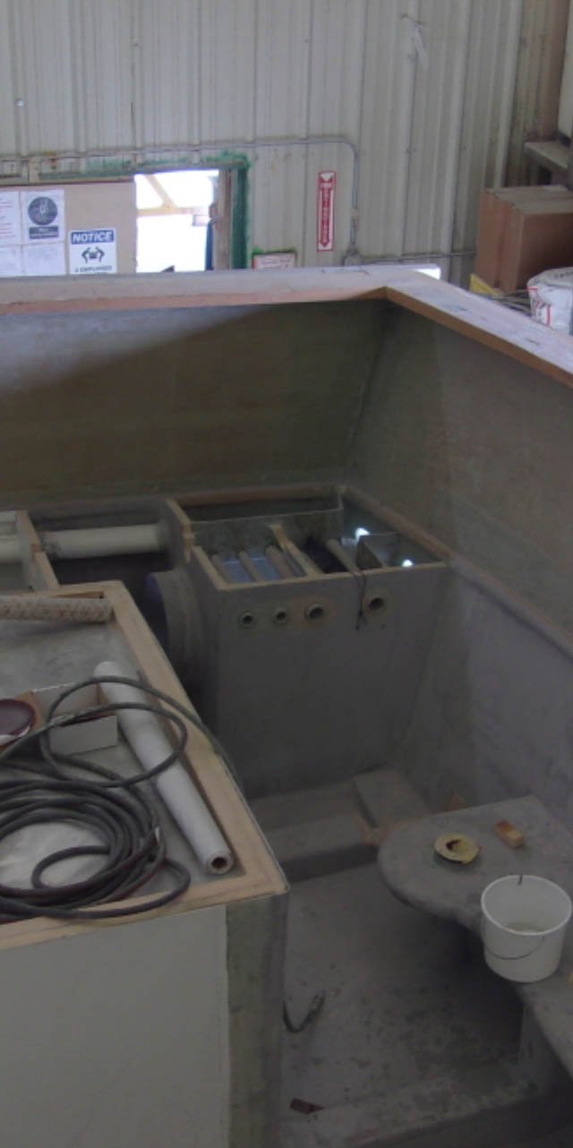

    Must have small bypass otherwise she'll shake at idle if exhausted underwater ANYWHERE on the vessel. Underwater exhaust is an upgrade for sportfishing boats, it's much quieter and doesn't blow water back in your face while backing down. My new boat has app. 2 x2 box under rear deck that has a cut out thru the hull. Cats can take higher back pressure than mtu. Hence my belief that's the reason they went out the side also. Once launched they can adjust back pressure by slightly enlarging the vertical side of the hole. Like 1/4" makes a big difference. One of the drains at waterline on the jim smith should be the bypass. This is what recessed tabs look like on most new sportfish boat if they didn't use fin style tabs.

    I would say that indent is to break up the water coming off the stern to eliminate a vacuum and reduce drag. I would expect it to carry under the bottom to also house the trim tabs (again to reduce drag as well as keep them out of the way).

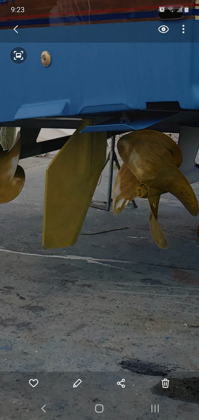

    Actually opposite is true. The hull directly behind wheels and rudder is extended to prevent cavitation pitting at high speeds. Laminar flow around all the running gear is important to prevent pitting and additional drag. That little bump is all it takes.
