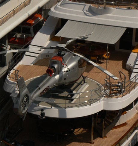

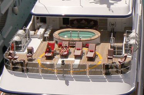

  4. balboa
    balboa Guest
    Helipad sizes
    Well, I guess the images below show that even the multi million $$ yachts don't have certifiable helipads on board.
    Both the Attessa and Ambrosia obviously have a space issue. We'll actually have more landing space.
    I feel better now :)
    Thorwald
