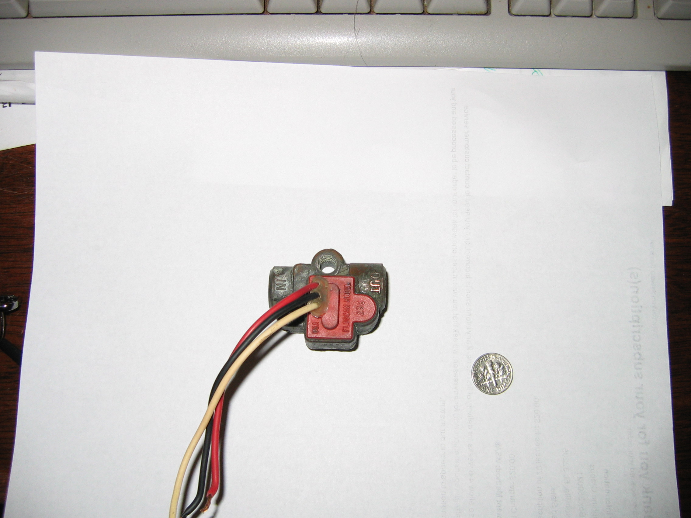

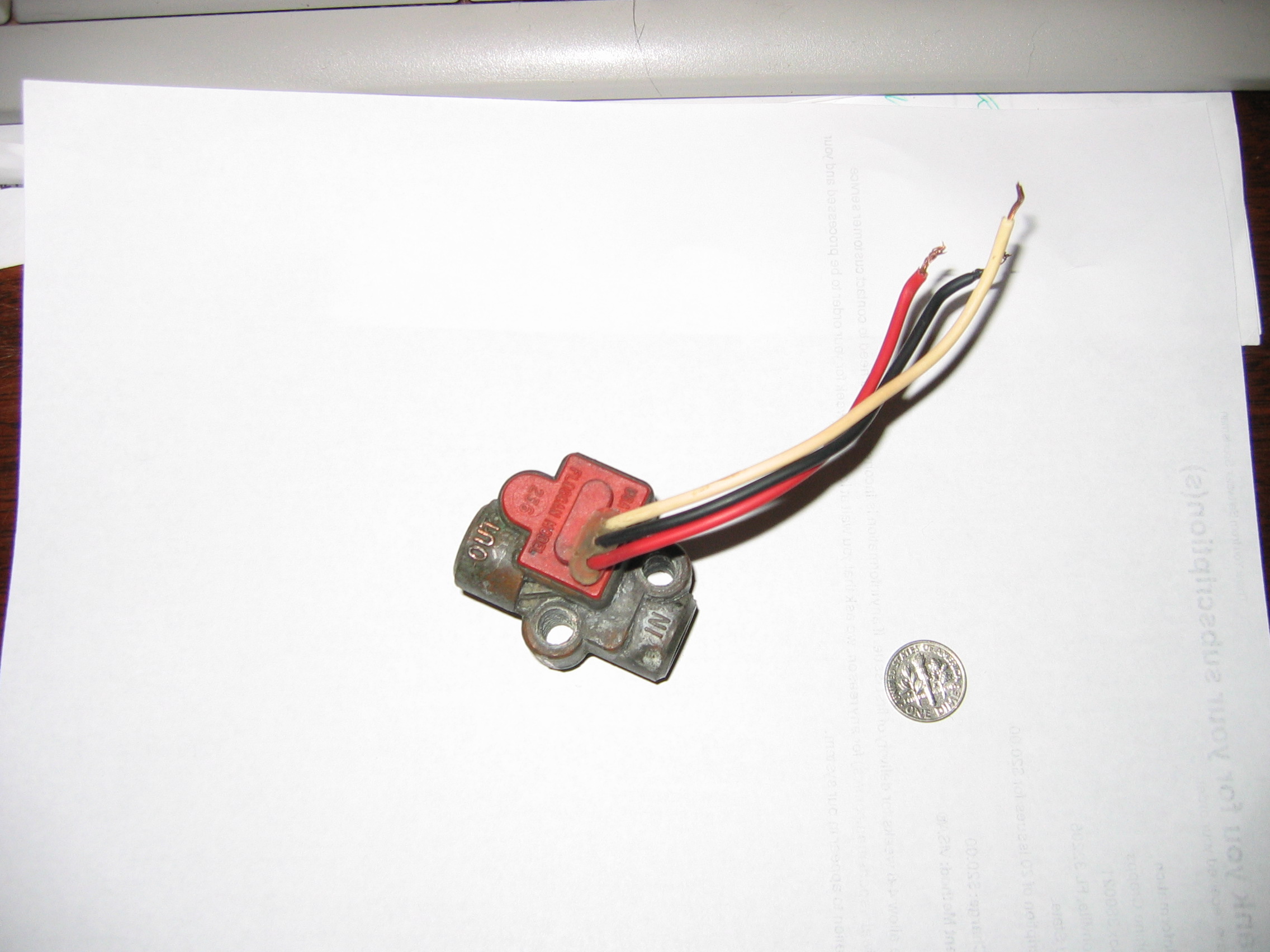

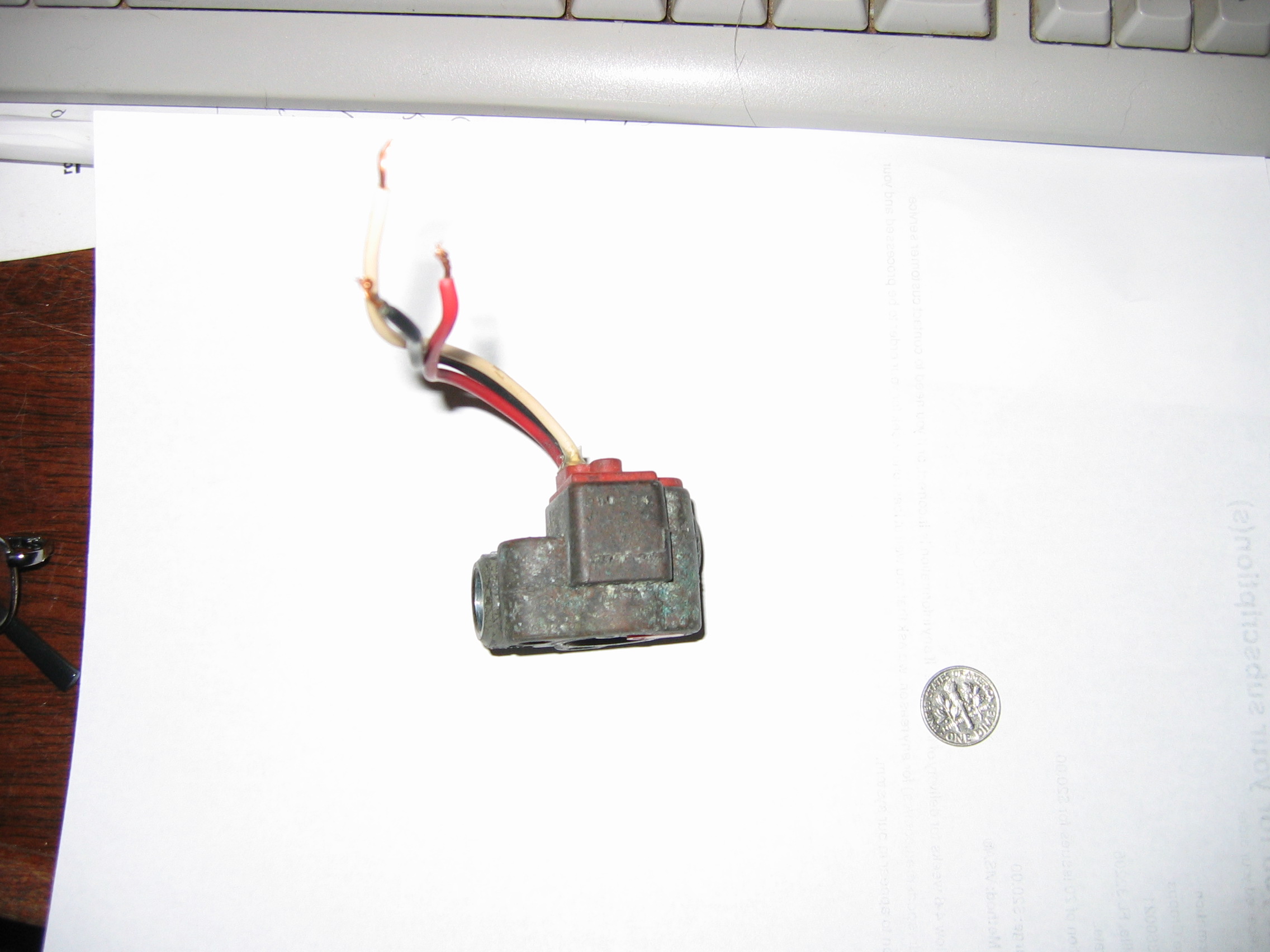

  2. Capt Ralph
    13,889
    Picture of the whole assembly. Pictures of just the sensor.
    This is a smooth bore sensor. A pipe with O rings make the fluid connection. Not threaded fittings.
    Maybe one collecting dust in your workshop
    Thx, Ralph
