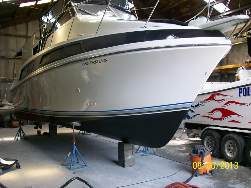

    Have had a large Danforth Fluke for years and had good success. Wanted to change to a Delta Plow (fixed).
    Lake Lanier, GA. soft mud, clay and such (fresh water)
    Should I do it? It sure would look and fit the pulpit better...
    Like overnighting on the hook...
    Thanks,
