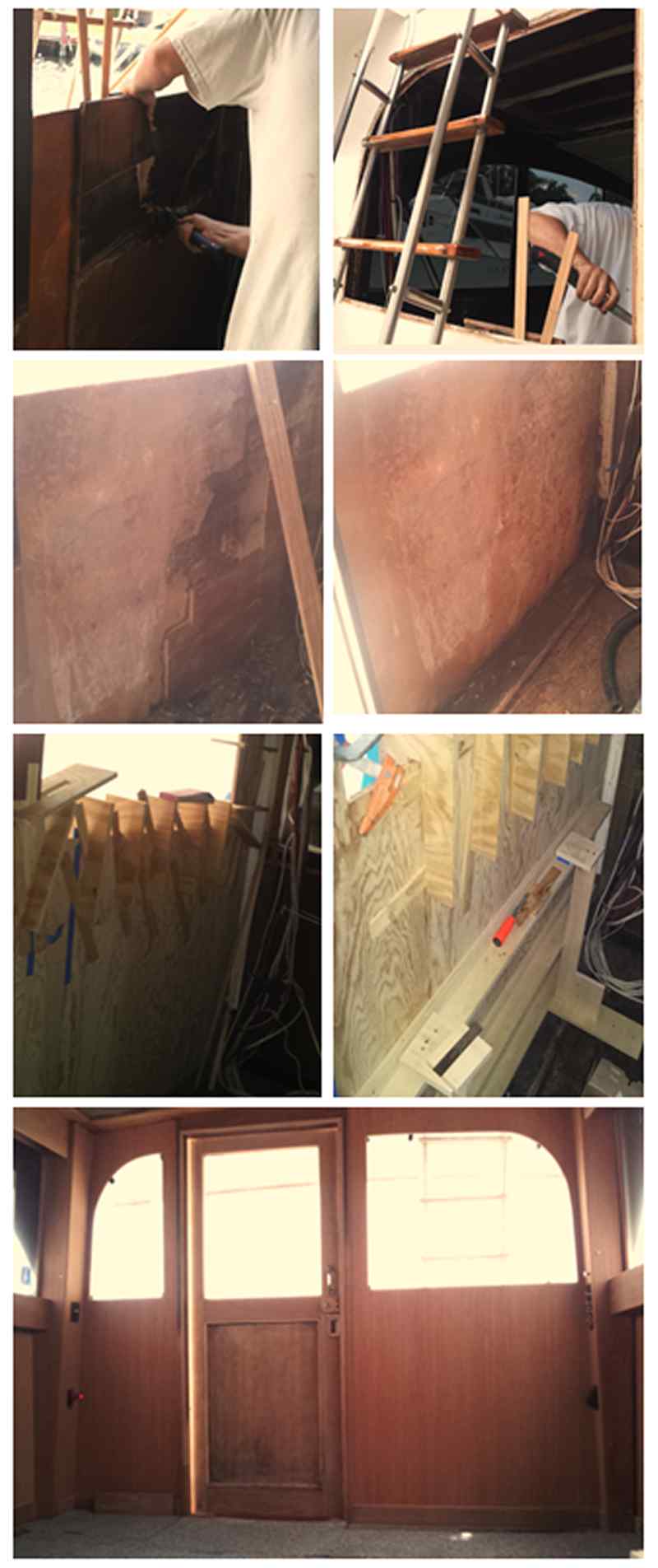

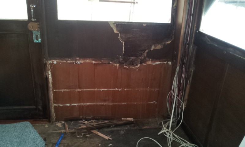

    I had this when I bought mine, it came from water intrusion for the outside for many years. Water came from the flybridge down thru the ‘ladder opening’.

  7. P46-Curaçao
    P46-Curaçao Senior Member
    Mar 8, 2013
    734
    We renewed the complete interiour...

  9. P46-Curaçao
    Mar 8, 2013
    734
    Yep, sealed everything properly, and closed the rear of the Flybridge and mounted Cockpit Sunshade, so no water reaches the windows...
