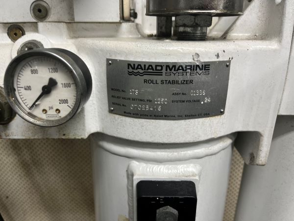

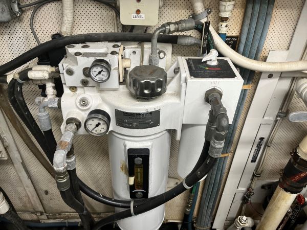

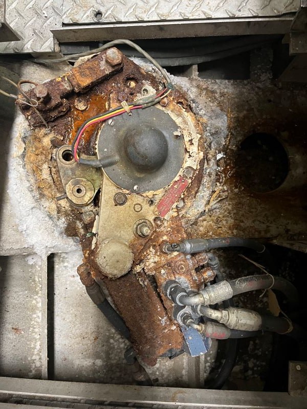

    We just surveyed an 80' Burger with Naiad 173 stabs on it. Overall the boat was in decent shape. Engines and gennies well maintained, boat sea trialed well. The only surprise we found was the stabilizers. They are in bad shape and need to be replaced. Attached are a couple photos of what we are dealing with. It looks like we would need to drop the fins, replace the head unit/acutators, seals, etc and replace any compromised hull plating at the penetrations. Can anyone give me a ballpark of what to expect for cost? We have the yard and another mechanic working up some numbers, but any information is always helpful.

    Jeez... Those actuators are in awful conditions indeed, how old is the boat?
    A few comments, anyhow.
    1) regardless of boat age, I have a funny feeling that there's something going on between the fin actuators and the (aluminum, I guess?) hull.
    Before replacing them, I would ask a knowledgeable technician to check if that installation requires some additional bonding, anodes, whatever.
    For your reference, I'm attaching a photo of the same actuators in my previous boat, which was 21 years old when I sold her, and never needed anything at all, but they were installed on a wooden hull.
    2) as far as can be said just by looking at your photo, the main unit seems in pretty good shape, with no leaks.
    In your boots, I would paint all the hose connectors, as it seems to have been already done on the two in top left side, near the gyroscope unit.
    But that's easy peasy.
    3) you don't show the pump, which must be attached to one of the engines (either belt driven or via PTO).
    Check if that is also in comparably good shape!

    Agreed on size. I'm 68 feet with 252's and 7 foot fins. By the look of the photo of the rust scale, I'd guess they lost a seal on the shaft at some point and never cleaned it up. There's both an outer and inner seal with bearing between them. I'm fastidious about replacing outer seals every few years. Replace the bearing and inner seals perhaps every 5.
    I would look at this as an opportunity to upsize the systems a bit as the delta in the investment isn't significant, and I'd guess that the responsiveness of the smaller system leaves something to be desired when things get sloppy.
    Being somewhat undersized, the armatures may have promoted a seal failure from stress and heat. Who knows..but that's what I think I'm seeing from the decay.

    No idea of who/when installed those stabs on your boat, and how they performed.
    But frankly, a 170 series system seems so badly undersized that I'm very skeptical it can be anywhere near as effective as it should.
    In other words, I appreciate that budget can be a limiting factor (it is for most of us!), but it seems to me that by replacing those actuators you would throw good money after bad.
    In your boots, I'd rather strip them, fix the hull plating, and put a removable cap on the hole.
    Whenever you will have a budget for a properly sized system, it would be easy to re-open those shafts holes and use the fins placement, if nothing else.
    And after all, boats have been around without stabilizers for ages, so you might as well find out that the boat is OK without them...

    that is exactly what we are leaning towards right now. Rather than have a couple of holes in the boat for what is effectively a useless stab system, we might as well plug the holes, get the boat up to the northeast, and then do it the right way. Also have a couple of quotes coming to get it done in NW Florida, so if it is cost effective, maybe have it done there before heading north
