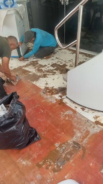

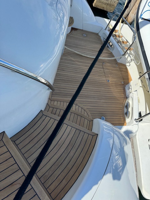

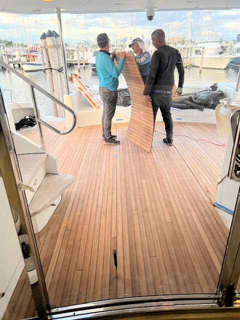

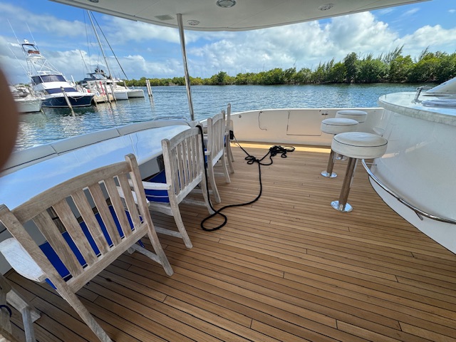

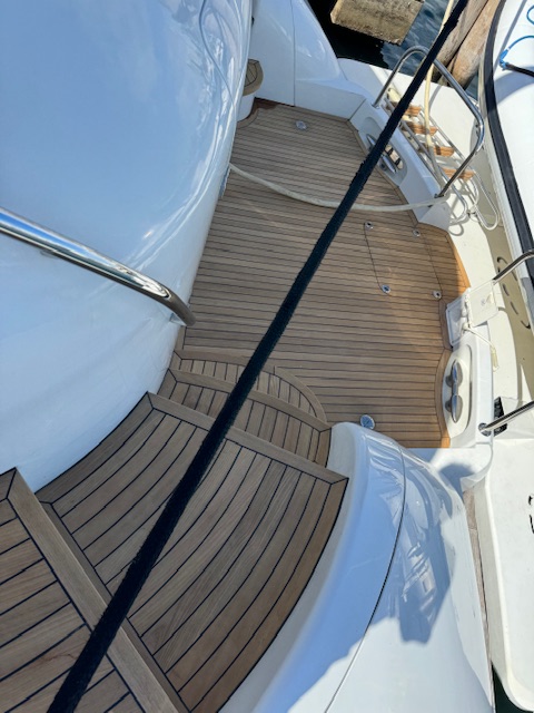

    one the final projects in the refit of the 2005 Lazzara 110 skylounge I took over 2 1/2 years ago was the teak aft deck and steps. The boat also had a drainage issue in the cockpit (non skid) with water pooling against the transom. We added drains which helped but decided to use teak, properly angled for drainage
    I had gotten a few quotes, most were over $100k. I ended up using Santeak Marine Carpentry in Miami (their shop is at APEX on the river), I had seen their work on another boat here at the marina. $63k incl tax and everything for the aft deck, steps on both sides and the cockpit.
    They prefab’ed the panels after taking patterns last month. It was installed last week and I m very happy with the results. Took them only 5 days to remove the old teak and install. No screws, teak panels are epoxied to deck. Raw teak is 5/8 before sanding

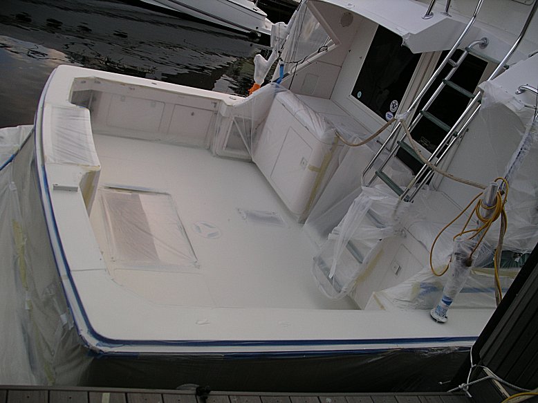

    So the teak is not individual boards? Looks like same "nasty" glue that my, teak no more was held down with. I had the glass done in Awlgrip with some non skid.

    Looks good to me. Are there seams between the panels?

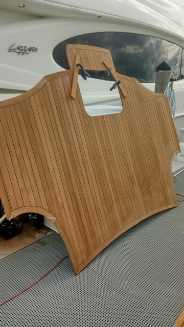

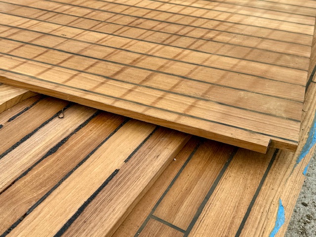

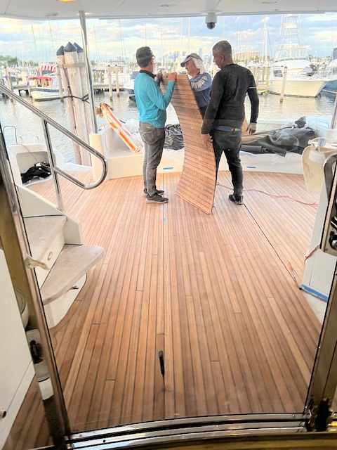

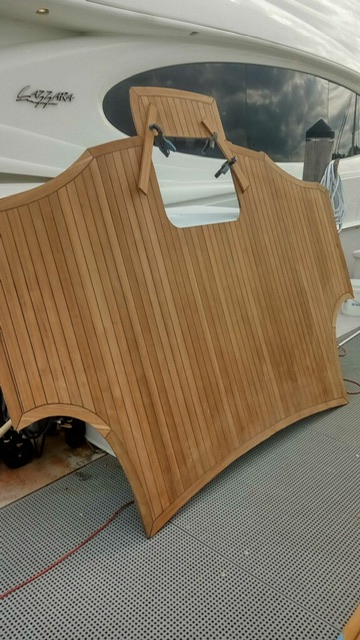

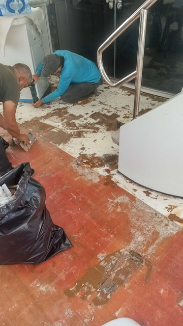

  4. Pascal
    8,739
    It an all individual teak strips but pre assembled in the shop with the black sealant. The deck was done in 5 panels, epoxied in and then caulked. You can’t tell which seams are the panel boundaries.
    here are a couple of pics of the panels before and during install
  5. DOCKMASTER
    DOCKMASTER Senior Member
    Feb 26, 2012
    1,560
    Ketchikan, Alaska

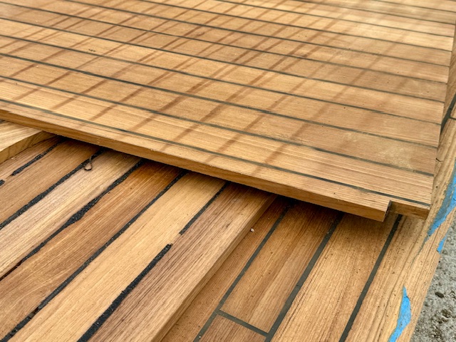

    How are the panels formed? What holds the boards together in a panel? I don’t see any kind of backing board in the picture.

    Ok, think I understand. Panels were full length & somewhat thin with width added by joining along any seam. Glue lines underneath running across seams in 2nd pic?
  7. Pascal
    8,739
    There are no backing boards. It’s the black caulking that holds the strips together before installation.
    the 2nd picture in my last post shows the bottom of the panels

    I remember a project that came into the Huckins yard. Outside contractor (unkown). All details transferred to cardboard. Plywood backs made.
    Return to the boat with these plywood backs for fine fitting.
    When they fit perfect, Teak strips were then fastened (glued?) to these plywood backs.
    Then these large sections glued (globes of glue) down to the original rough decks.
    Looked fantastic.
    I'm assuming, if your original deck is real flat, that plywood back would not be needed.
    Then a fine job as on Pascals rig could be installed.

  9. Capt Ralph
    13,889
    In your pictures, I can realize the teak strips are glued directly, then a black caulk line added.
    In pic 0076, some of that black caulk has been scratched off the teak.
