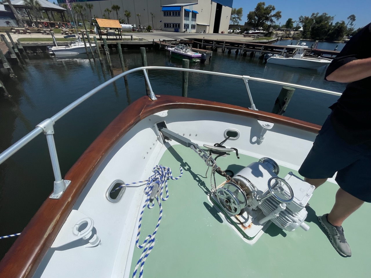

    Looking for some thoughts on a replacement windlass for the 80 foot Burger.
    the old one is a fossil and probably only good for an anchor itself at this point. It takes up a good bit of deck space too.
    Any suggestions on make/model to replace it and whether to go hydraulic/24v, etc would be appreciated

    I m not a huge fan of hydraulic windlasses unless absolutely necessary. Loose hydraulics and you can’t raise anchor…
    do you have a thruster? If electric you probably already have batteries at the bow. If hydraulic then you already have hydraulic there so it may be easier to go with an hydraulic windlass.
    I have an old Galley Maid on my personal boat but I’ve had good luck with Maxwells on boats I ve ran, both electric and hydraulic

    The current windlass is the original Ideal and it is powered of the AC side of the panel, so basically the generators.
    we have a 210 lb anchor on there now, with a chain and rope, but I will be replacing both when we do this - new windlass, new chain and line.
    I looked at maxwells, but had a hard time finding any dealers up here in New England?
    Aquarius makes a vertical model it says is good up to 90’ boats, but I’m not familiar with the brand.
