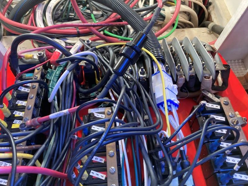

    Do you have power at the terminal for the DC main breaker on the back side of the panel? If that breaker goes bad you will loose DC on everything else.

  7. Greg Page
    Greg Page Senior Member
    Mar 4, 2017
    456
    Annapolis MD
    If you need to trace the cable it is the one exiting top right in the photo. There is a junction block on the back face of the plywood where you can't see it. Should be easy to find where it exits the box in the engine room at forward bulkhead.
    Mine is non-standard from there but you hopefully can follow the cable once it's in the engine room.
  8. FencingAg
    FencingAg New Member
    Oct 10, 2022
    16
    Lake Charles, La
    That does help, thank you. My wiring behind the panel is more of a rat's nest than that, and I will be going through all of it again this weekend. Thanks!

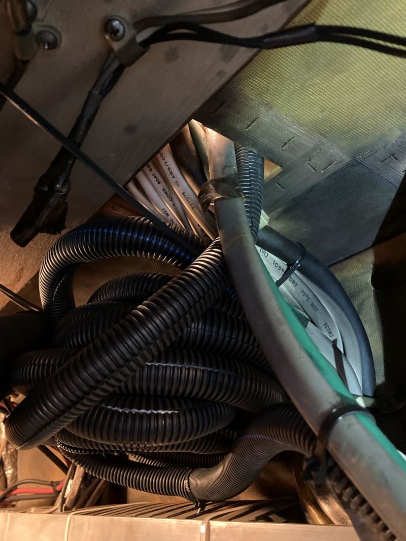

  11. Greg Page
    Mar 4, 2017
    456
    Annapolis MD
    This is the bottom side in the engine room. The heavy cable right in front is the DC (-). One of the black cables in the bottom left is the DC (+). The snake is the control cable to the genset that I need to pull out, shorten and re-pin. Installer did a good job on the rest of the wiring so I guess he didn't have tools or pins to re-pin that.
