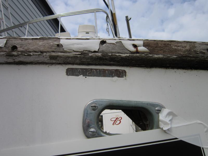

    Hi, Maybe I am unclear on Post Hull numbers, but I always thought my 1975 42 was hull 15 as shown in pic attached.

    I see PM042016M76 I would take that to mean Post Marine, 042 feet, 016 hull, 1976 model year. Mine does not have the in hull marking, however in Egg Harbor tradition, Post marks components for the hull they are to go in, at least they did back in our day. If you pull the center engine hatches the aft inside of the starboard longitudinal (removable) hatch support will have numbers stamped in it. The last number or numbers is, I believe the hull number. If it isn't, I've lied to many people about mine being 42 #3!;) ;

    Thanks, if you are able to zoom in you would see the 6's are actually 5's. Hull 15 built in '75. Which is also what shows on documentation/title documents. My boat also has an original Post plaque with Hull 15 on the mahogany overhead above steps down to galley.
    I haven't noticed any other hull ID in the hatch location described (but I do have another boat that has her official stamped hull number but she got a few components marked similar to what you have described for another hull number - the factory was careless I guess - so I trust what is stamped on the hull).

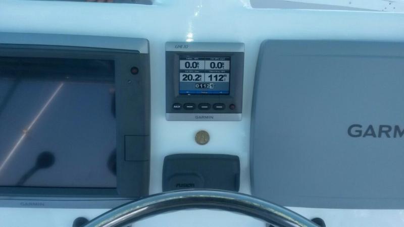

    Cool! We are happy with the 17-18 the boat is making, And my friends of the marina lost the wagger!!! She did more of the 14 they expected!
