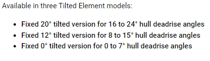

    You can eyeball the potential locations inside the hull to guesstimate if the inner and outer hull location would be roughly parallel. You could then measure the area with an electronic level device or even a phone app. There's some range in the transducer fitment angles. From Airmar "Chirp" type:

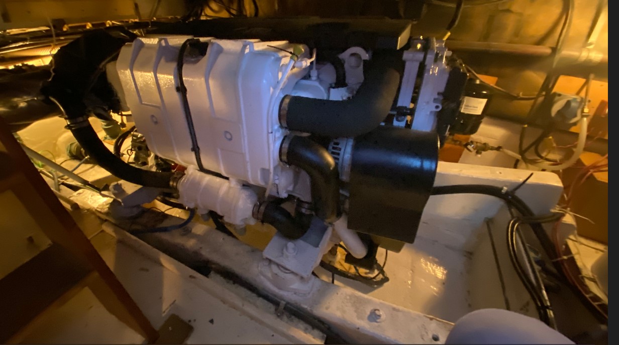

    My transducer is underneath the port engine. I can measure the angle there (inner, no frames there so should match outer) if you would like. Note I have CAT's, space under a DD may be different. I think it's been in that location before the repower by PO but I can't swear to it.
    You can see it at bottom of the photo. My engines are shorter than the DD so don't judge by the forward mount, mine are further aft. You can see the original mount holes further forward on beam.

    Wow, sweet install. I assume a ZF clutch offering that down angle so well?
  6. Capt Ralph
    13,889
    I see a real 'ducer down there with fairing block. Should be in real clean water mounted there.

    Transmissions are Twin Disk.

    Transducer is happy there. Water pickups for GenSet and on opposite side AC are just in front of the thin bulkead and both run fine underway up to top speed so good water flow for them too.

    With a down angle or is it the picture that makes the engine look level?

    Drive train is straight. Engine beds are on shaft angle.

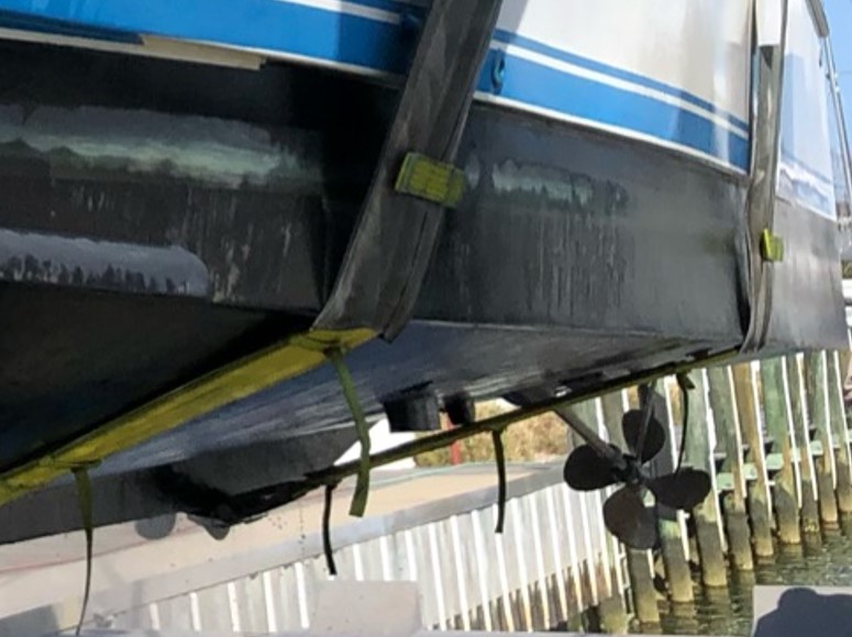

    Not the best photo but gives an idea how the deadrise flattens out from the engines (reference the transducer block) going aft to the transom.

    I'm sure it is, but your hull photo suggests it's rather the prop that could be not so happy.
    Such a big transducer right ahead of it is bound to disturb the water flow, to some extent...

    Port engine runs 3% more load at cruise, washes out as hit govenors at full throttle. Engines are same rotation, port transmission runs in reverse. The extra gear set would be expected to add 2-3% efficiency change (yes, I have designed torque split transmissions) so is well within expectations for good design. Wake from transducer would be on shaft centerline, so at the minimum impact to propeller, wake head loss but no swirl (I also design propellers).

    Just so cool to see an engine with room all around, including under the saloon deck.

    At first look you would think some disturbance at the prop, That far forward, I don't think so.
