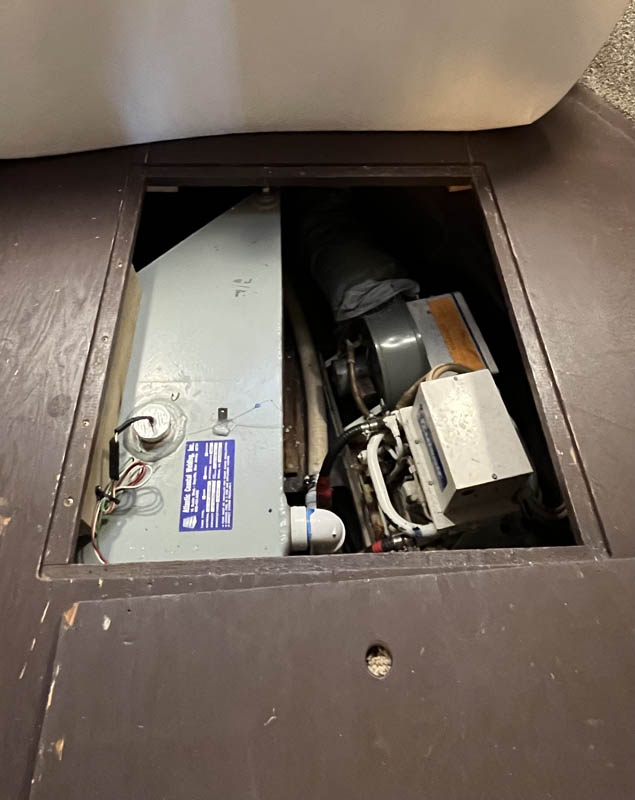

    Has anyone replaced the blackwater holding tank on a 43 (or similar) located in the dresser cabinet below the forward birth? The current tank is 29 gallons and the space is shared with the forward AC & air handler. I would love to shoehorn a bigger unit in if at all possible. Appreciate any tips/suggestions from the group.

    Here’s a photo I grabbed today of my current config.

    If I could relocate the forward air compressor / air handler, I’d squeeze in a 50-60 gallon holding tank under the bed.

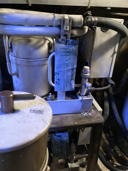

    AC units are one above the other in engine room. Water heater is seen off to stbd.

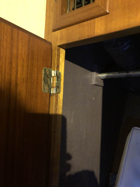

    Fwd air handler location barely visible in the pic (don't seem to have a better one) above the forward stbd closet.

    Update with better picture of fwd air handler in top of stbd master closet (I had it open doing the AC controls replacement).
