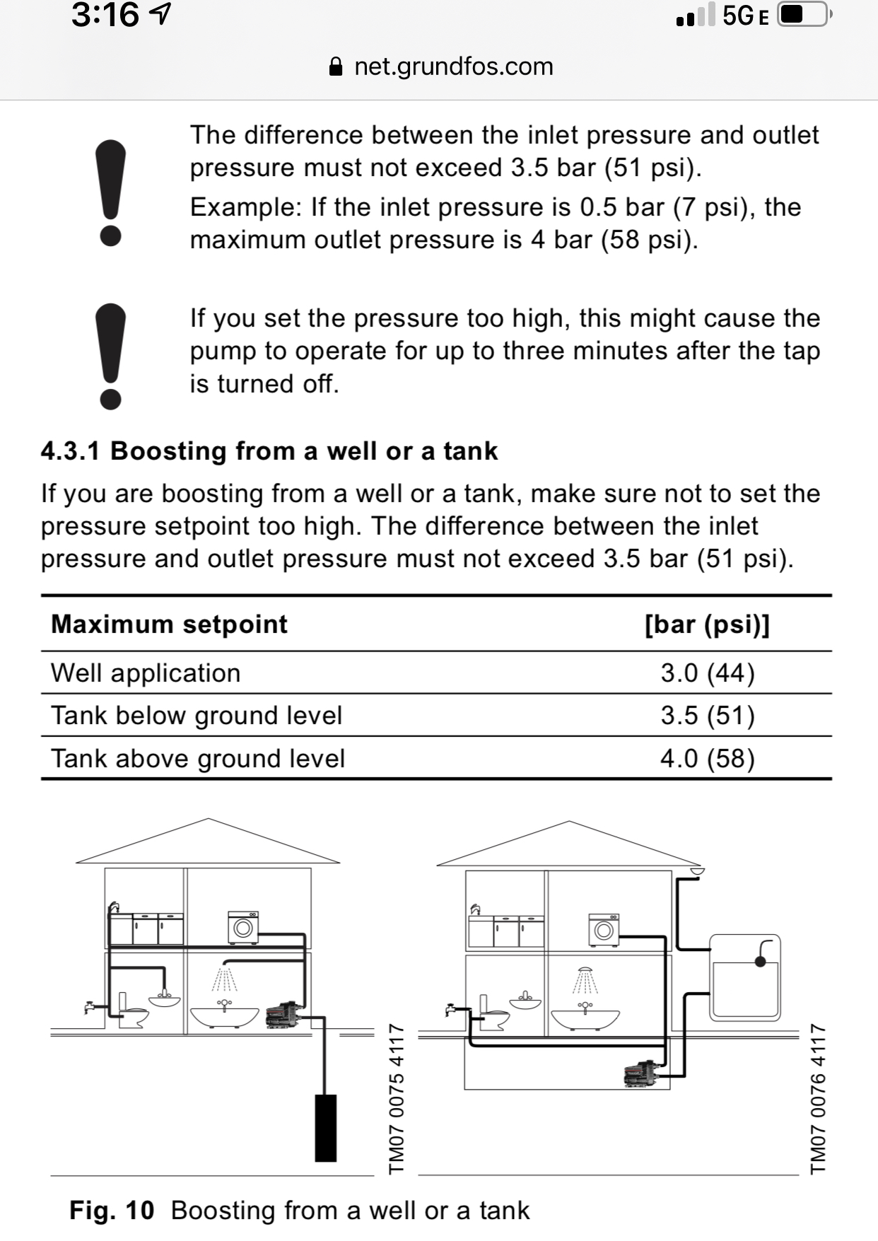

  6. Pascal
    8,739
    well... so much for the Groundfos Scala 2...
    I spent a couple of hours replacing the Mach 5 with a Groundfos. It took some plumbing work since the outlet is in a different location on the pump. To be safe I only used threaded sch 80 PVC in case I had to switch back... and I m glad I did.
    The Groundfos primed right up and worked fine until I tried raising the pressure from 48 to 60 PSI... no luck. It wouldn’t go past 50PSI which isn’t enough to flush the headhunter heads.
    downloading the full manual, I found out that while the GF can go as high as the advertised 70 to 80 PSI, it will only do so if it has 20PSI on pressure coming in the inlet.
    that little detailed isn’t mentioned in the pump specs...
    reinstalled the HH...
  7. Capt Ralph
    13,889
    Pascal
    Sorry you had problems.
    However, I am very confused with your issue.
    After my post above, I have installed this pump on boats with the old HH heads.
    With the pressure accumulator still intact and no adjustments made to the pump, The heads still work perfect.
    I wander if your accumulator has a bad diaphragm on needs some pressure added.
    OR, do you have an accumulator as per the old HH heads install requires?
  8. Pascal
    8,739
    I checked the accumulator pressure a couple of weeks ago when I was troubleshooting the HH. Pressure was fine. I don’t recall the number off hand
    the scala 2 cannot over 50 PSI, I have a gauge Teed on the outlet line. If I set the pressure to a higher level on the pump panel, it will keep trying but eventually stop, throw the “can’t reach pressure” error and then automatically lower the pressure setting to default.
    our HH heads are 2009 vintage, don’t know if they more pressure than earlier one but unless the gauge shows 55 to 60 PSI they don’t flush correctly
    I don’t think adding pressure to the accumulator will help as the pump won’t be able to overcome the pressure in the bladder.
