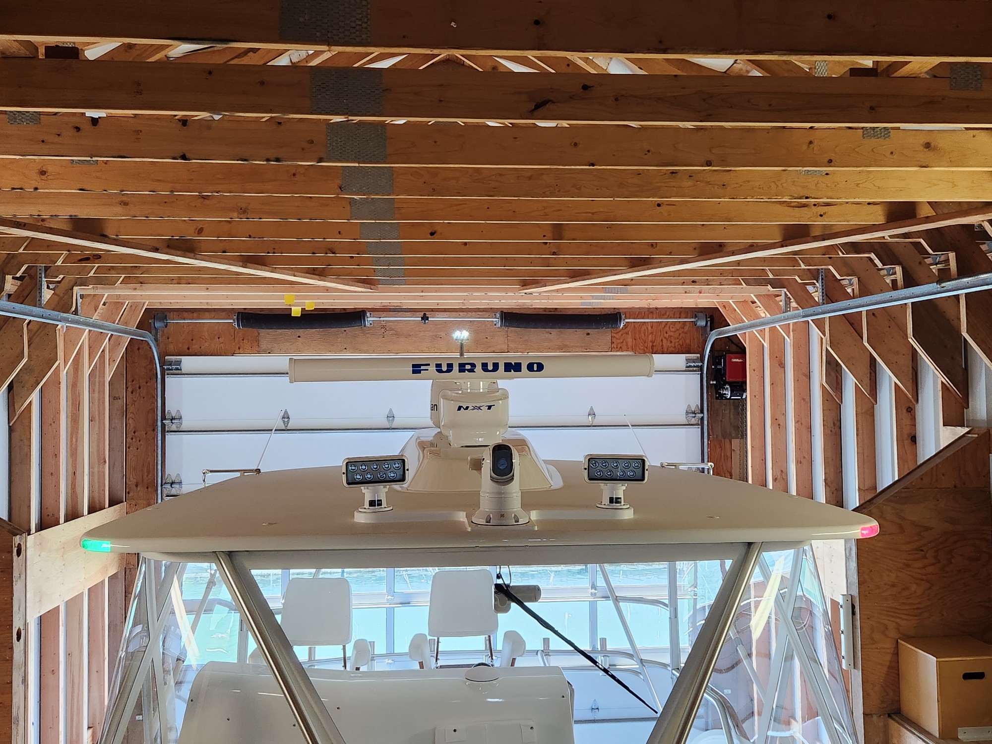

    How strictly enforced and what are the clear rules for Navigation lights on power boats over 39ft and less than 65ft. I am replacing the masthead light on my Cabo 48. The boats Nav light system is 24v and the Pipewelders placed the red and green side lights in the corners of the hard top. They placed the white stern light in the rear centerline of hard top. Very clean and nice led install. My challenge is two fold. One being that the boat is 24v the led light options for a proper masthead anchor light is limited. Second is height related. I go into a boathouse and the top of my radar is very close the to hitting the door already. Also given that the side lights are mounted in the top corners of hard top if I use the 3ft height separation to masthead I would have to place light on 3ft pole.
    After going down this rabbit hole of research 9 months ago when I was in the beginning stages of refit I ordered a Lopolight that fit all the criteria and appeared high quality. Now it is time to mount the light and if I have to adhere to height of 3ft above side lights I will need to place on antenna ratchet mount so I can tilt back coming and going from shed. If I don't I can incorporate in the fwd thermal camera mount and place at same level as radar.
    I have looked at build photos of countless boats and Viking places the light high yet many of the custom boat builders appear to not mount the light at the highest point of vessel or 3ft above sidelights. Curious what others opinions are of this. Thanks.

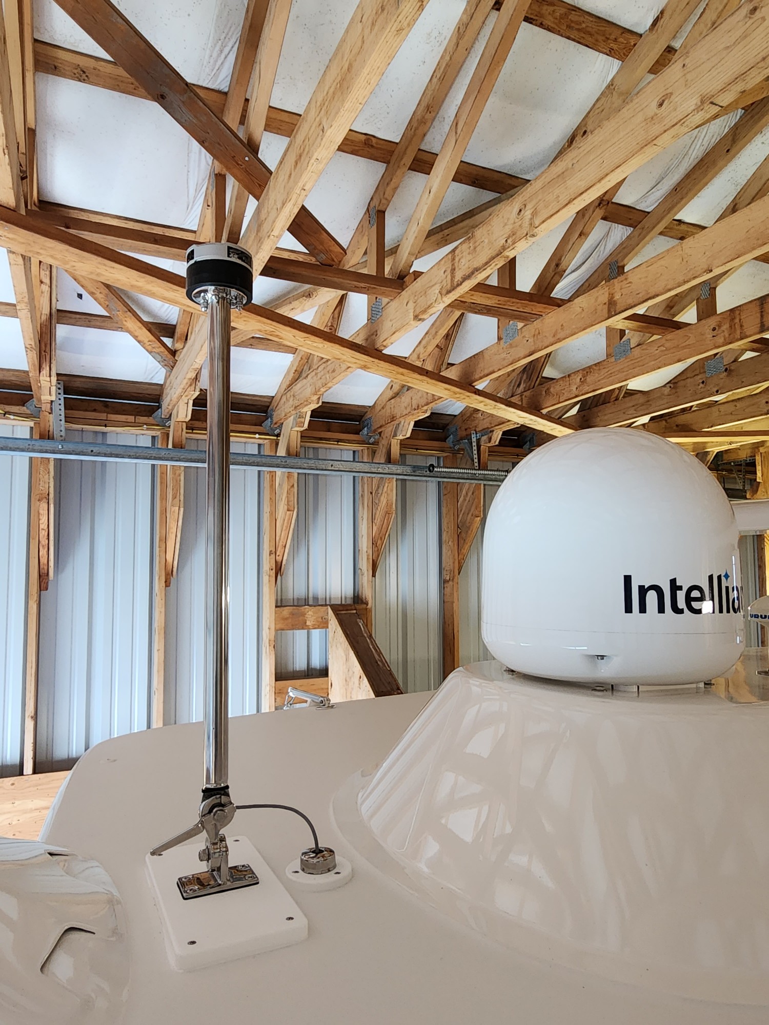

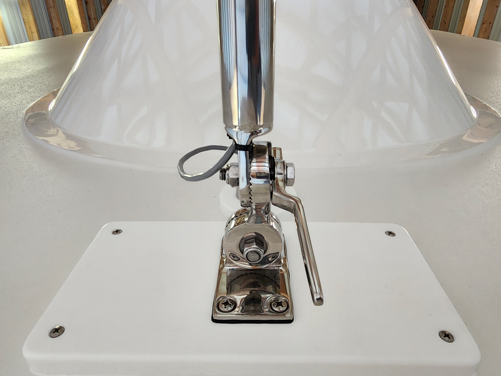

    Got the masthead anchor light dialed in on the 2nd go around. Given the need to be above my red and green lights which are in the hardtop corners as well as above my radar I needed to mount light on a ratchet mount to go in and out of boat shed. First time around I had digital antenna make me a custom fiberglass extension at 30 inches. Threaded onto ratchet mount and light bolted into GPS base at the top. Looked good but had too much vibration when you bumped it. ie 4foot chop on the bow at 30 knots. So round 2 was heavy duty ratchet mount into 3/4 base pad as well as using small aluminum pmate in hardtop for center rigger base. Had a 1.25 inch ss post weeded to ratchet mount and GPS base st the top. Thru bolted light to GPS base. Looks right and feels right. ✔️ ✅️.
    There is a surprising small number of options in the 12m to 20m 24v LED space.
