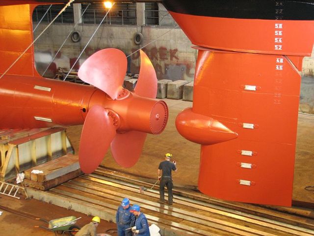

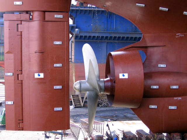

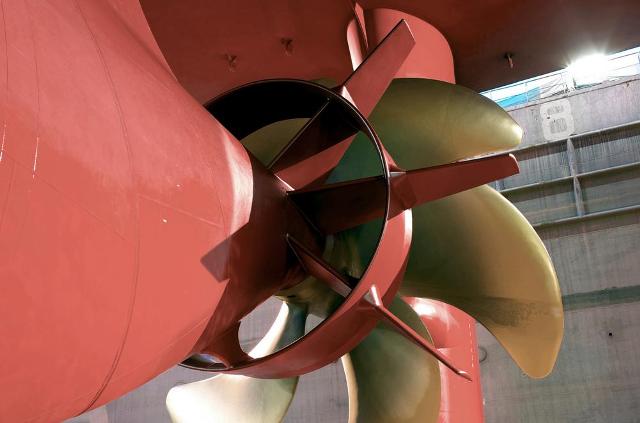

    All sorts of things are being tested in order to safe fuel on big commercial ships. The newest development was the twisted fin. A method of predirecting the flow towards the prop. Now the Mewis duct, the twisted fin and the twisted rudder with Flap and Costa Bulb have been combined on one ship. The calculations call for an reduction in fuel consumption of about 8 to 9 % at given speed. Gentleman, in my business, that is a LOT. We are talking $$$$$$.
    1. Mewis Duct and rudder with Flattner Flap, 2. Twisted Fin, 3. Twisted Rudder with Costa Bulb.
