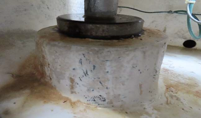

    I'm helping on my new best friends 2000, 42 Post.
    Rudder post are seeping.
    I remember somebody working on these before but my search skills are not working well rite now.
    How did these work again?
    Serviced how?
    Can somebody point me to that old thread?
    Thx

    You may want to call Wharton Creek to see if they can look it up for you. I assume they still have all the drawings. I've never seen a seal like that and the Tides website doesn't show that particular seal.

    It looks like a Tides to me. I had one fail on the 110 last summer. The top part screws in for some reason it back itself out. We replaced both sides and added set screws.
    ours had serial numbers and we were able to look them up on the tides website to order the parts

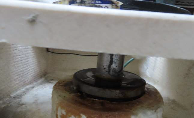

    My note;
    The above photos were also included.
    Good day
    Can you help us identify the required parts and instructions on servicing our rudder post seals?
    Thank you for your time and thoughts
    Ralph
    Worton Creek responded this morning;
    Ralph,
    When the boats were built, they used Tides marine rudder seals. If is not tides then im not exactly sure sure what kind it is.
    Patrick
