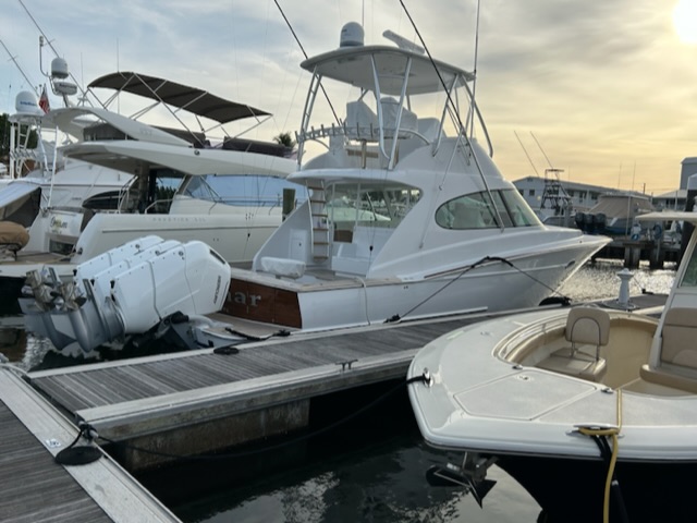

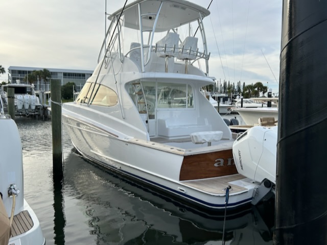

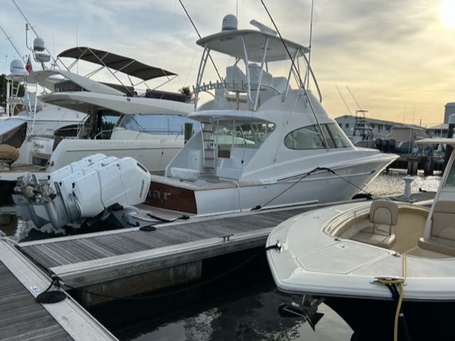

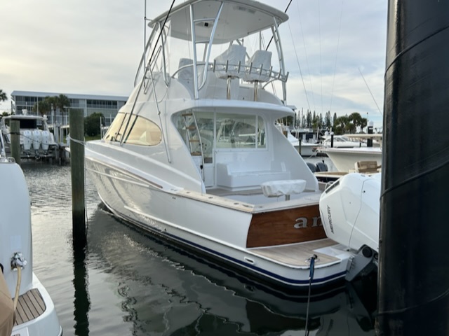

    Saw this one at Palm Beach Gardens. No badging so I don’t know who made it. At a casual glance looked well made. I am not an avid fisherman so don’t know how the OBs affects fishing. Is this the future of smaller sportfishes? To me beats the hell out of a similiar sized center console.

    Thats an Xcelerator 45 made by Joel Kauffman and was launched last year.

    You'll have Tuna Tartare trying to land the fish on the back of the boat, along with no transom fish door...Put some diesel inboards in that thing, plus you'll have a safer more sea worthy vessel.

    Probably more comfortable then a CC but I certainly would not want anything between an angler and a large fish.

    I've been out on outboard fish boats before.
    The captain/operator is the key.
    When the fish is close, he (she) keeps the beam (not transom) on the fish.
    So in this boat model, the deck house sides come back to help keep spray out of the cockpit, but ruins the fish-ability on the beam.

    Really depends what kind of fishing you are doing. For general reel in stuff shouldn’t be a problem to bring a fish alongside most times. But I don’t know how well it would work if you have to back down on a bigger billfish or tuna?

    Backing down on a Big-Un, I don't have any experience with; But, I can imagine chasing a monster down forward at an angle may be an idea.
    Again, on this boat above, that deck house trim bulkhead will be a hinder using that theory.
    It is a good looking boat. I fear, not a great fishing boat for a few reasons. Probably just fair/good for coastal kings & mahi-mahi.
    A new 42 from this builder is near $1.6 meg. https://www.**************/yacht/2023-xcelerator-boatworks-express-8631028/
    I would be poorly guessing what this 45 would cost ($2m?).
    IMO, that is to much money just for a fair/good fishing boat, no matter how fast - well it rides.
    At 45' (LOA?), I'd still prefer my ole 44 Striker.
    I wish somebody could talk to the owner and ask him(her) how well da boat does fish and how they manage hooking a Big-Un.

    I do agree fishing can be tough on that rig. Outboards don't create as clean of a wake as diesels. Even with bow thruster, don't think it will spin around as much as a typical sportfish. Imo, it's like the worst part of both options. Regular diesel sportfish can maneuver very well, back down well, etc, but you can't walk around to the bow easilly. The main advantage of outboard CC's is the ability to walk around which this rig doesn't have.

    Captain Ralph’s observations on fishability are spot on. Center consoles and walkaround expresses are great matches for outboards. With a large deck house and when the cockpit is all you have to fish from it changes the equation big time. Weight distribution is another factor - I’m guessing the designers on that sportie had to work really hard to offset the cg impact of having a big deckhouse and flybridge but no weight of big diesels in the bilge to balance it out.
