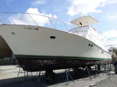

  19. P46-Curaçao
    P46-Curaçao Senior Member
    Mar 8, 2013
    734
    Just to show you...
    Just to show you...
