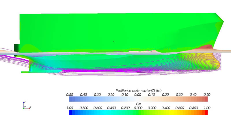

  2. The bulbous bow, with inset thruster, has a sharper vertical entry than most bulbs. The purpose behind this design is not only draw the bow wave lower at the waterline, but to minimize the pressure coefficient along the side of the bulb. Obviously the bulb is weighted to reduce pitching in heavy seas but it also serves as a collision compartment should this steel sled slam into something unforgiving.

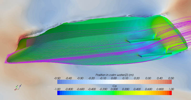

  6. Bering 77' CFD Pressure Coefficient Bottom View...
  7. Bering 77' CFD Pressure Coefficient Side View...

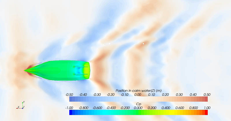

  8. Bering 77' CFD Wave Surface Pressure Coefficient...
