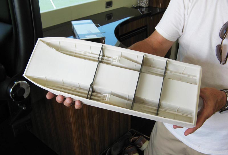

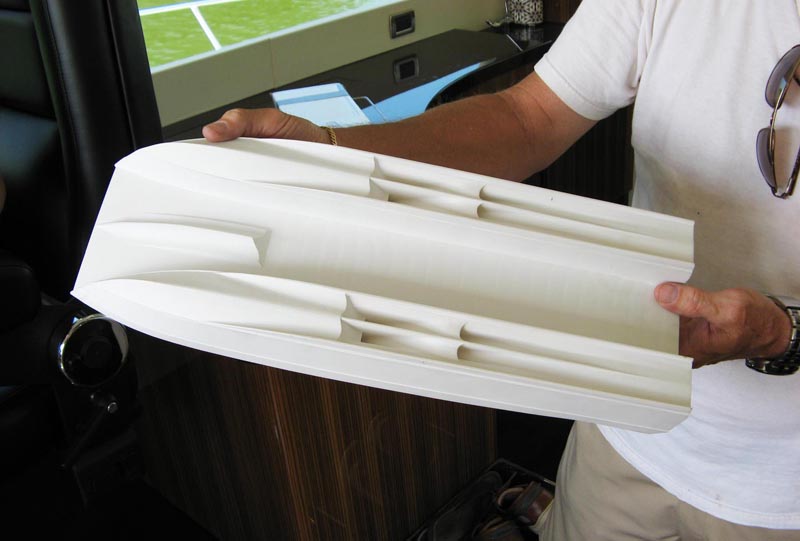

    This detail shot of the model shows the bottom of the hull. The intricate design delivers a startling leap in sub-surface technology.

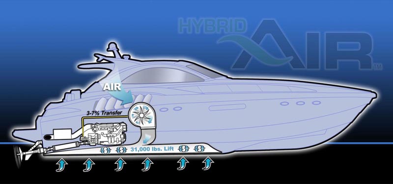

  2. Bringing three different hull forms together is where Bruce Barsumian’s brilliance came into play, along with a healthy dose of fortitude and persistence. The Axcell 65 Cat is based on a pair of symmetrical sponsons that are V-shaped at entry, but quickly transition into a cathedral design, then give way to a recessed cavity being pressurized by hydraulically driven fans; PTO’s from the main engines that power a hydraulic pump. This in-turn powers the blowers, providing some 30,000 lbs. of lift to a boat that weighs around 60,000 lbs. The fans take approximately 6% of the power off the main engines, which are C18s.

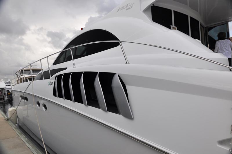

    And where is this air coming from? One of the most distinctive features of the Axcell 65 Cat is a pair of signature ‘gills’, located on each side of the boat. These intakes are both stylish and functional. Mounted above the sheerline, away from spray, they provide fuel to a pair of large, centrifugal fans. While this might sound like a lot of plumbing, it’s really no more complicated than adding a turbocharger, albeit a monster compressor!
    And what is the result of all this technology? Efficiency! As power on the C-18’s come up, the centrifugal fans engage around 1350 RPM’s, pressurizing the subsurface cavities and providing lift as the boat begins to plane. The fans are automatically synched to engine RPM and the transition is surprisingly seamless. A noticeable amount of lift takes place and it is felt midship, at the center of gravity. At an economical cruise speed of 22 knots, the Axcell Cat is consuming 23 GPH per engine; respectable fuel economy for a 65’ boat weighing in at 60,000+ lbs.
    This pic shows the inside of the hull...
  3. A side-view cutaway demonstrates how this semi-military style hovercraft application applies to the craft underway. Air is fed through the Gills and into the centrifugal fans which pressurize each sponson skirt. As the hull moves forward, air is channelled aft in a cavity that becomes progressively shallower, providing additional compression (lift) before expulsion.

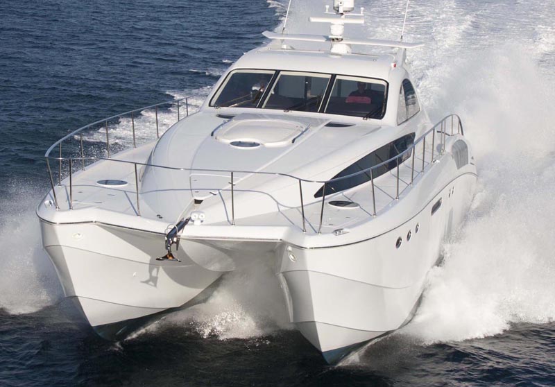

  5. If there is one area where the Axcell cat fails to excel, it is in ride quality over short frequency waves, such as one-foot bay chop being whipped up by high wind. There is an interaction taking place at the bow, between the sponsons, as water is displaced by the entry of each sponson and collides inside the tunnel at the same point that oncoming waves are passing underneath the hull. Refer to the oncoming, offshore running shot of the bow for a visual. The result is a fair amount of vibration being transmitted throughout the vessel, but only at a certain speed echelon. Otherwise, the ride was smooth and stable.

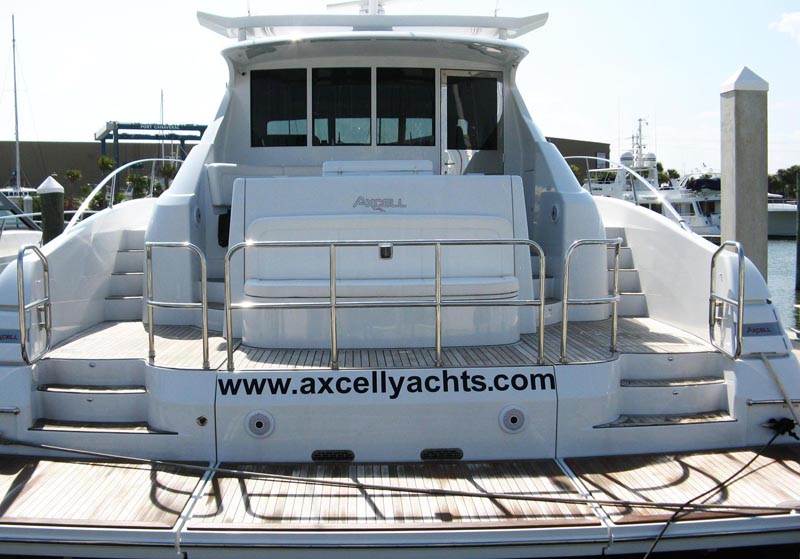

  10. A close-up aft deck shot illustrates the enormous space available at her stern swim platform. Sorry Bruce, we can't make this pic a hyperlink to the URL...

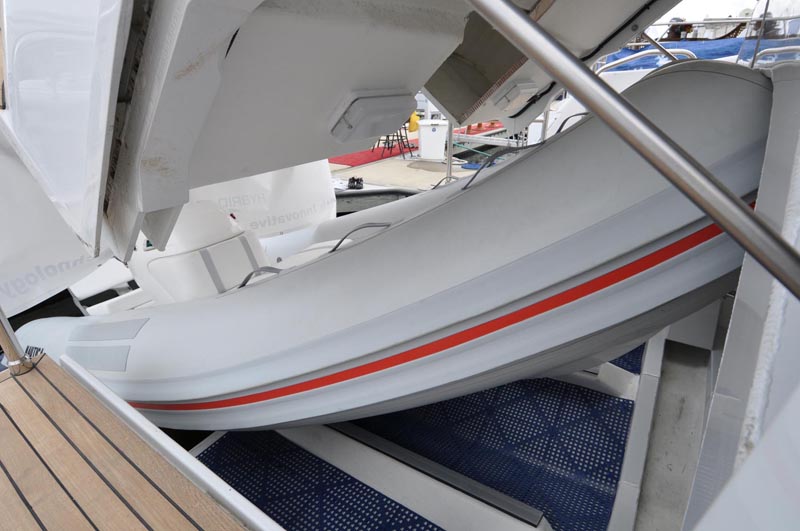

  11. Nestled under the swim platform and stern is a tender garage with a 15' inflatable RIB...
  12. This close-up study of her “Gills” is a graphic illustration of the creative thought and effort of inventor Barsumian’s essential performance secrets. His patented “HybridAir Technology is a product of those side “Gills”, where the blowers reside providing the necessary airflow to feed his new technological marvel.
