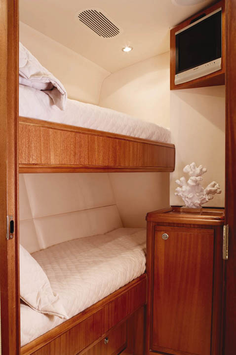

  1. The portside stateroom with it’s 6’6” headroom is where the crew or the gangly teenagers will bunk out. As in all the other staterooms, occupants can adjust their own air conditioning, watch TV or DVDs on the flatscreen, listen to CD & AM/FM tunes, and set their own alarm clock for the requisite oh-dark-thirty start for Serious Fishing. Storage is quite adequate in the hanging locker inboard or under the lower berth. No second-class quarters, the size of the ensuite head—just aft—rivals that of the VIP. Across the passageway is the laundry center.

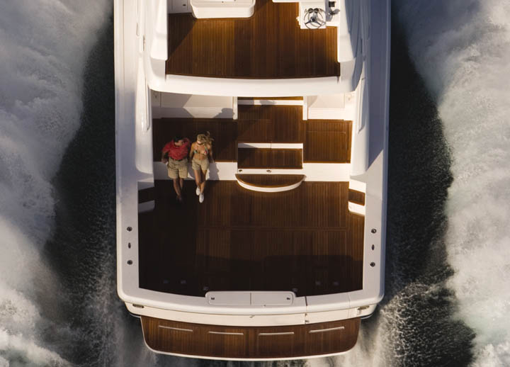

  3. The Business End...
    Two hundred and seventy-five square feet of cockpit might seem excessive, until there’s a multiple bite and all bedlam ensues. Backing plates are in place if one should choose to add a fighting chair and beneath the sole are two huge dunnage boxes which flank a seven-foot removable fishbox. Allegedly, someone in Ferretti management got their feet wet and so took issue with the previous cockpit drain method: now, the excess water collects along the periphery of the cockpit and feeds down into a plenum which then drains out through the transom via triple scuppers. Take that!
    At the foot of the mezzanine seating are three gas-hinged hatches which can become freezers or baitwells or whatever you wish. A portion of the step forms a lockable engine room entrance…and that door to the right of the salon entrance is a good-sized all-fiberglass rod locker with it’s own freshwater washdown & drain. All the necessaries such as fresh & saltwater washdowns, freshwater fill, lube oil waste (for an 80 gallon tank), shore power main inlets (both with Glendinnings), and the like, are tucked away near the foot of the pilasters. For the fishing cognoscenti, the height of the coamings are a near-perfect 26 inches and, yes, there is space underneath them to stow a large gaff or two.

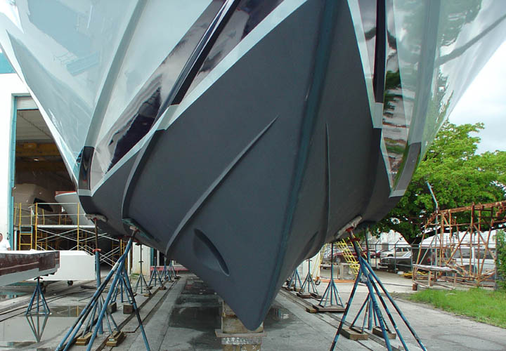

  4. Hull Bottom & Running Gear...
    The bow of this new 70 has more rake and has a noticeably finer entry when compared to this 57 (which has all the DNA of the venerable 54)—headseas will be met with a scalpel instead of the older steak knife. There are two strakes per side that run run aft about 40% and then cease. Twentyfive years ago, Bertram found that while lifting strakes offer dynamic lift (that old 31 had eight of ‘em), a penalty is paid in drag due to the additional wetted surface. The wide chine flats do the heavy lifting nowadays while the extra strakes add some spray-knocking capability as well as a certain styling element.

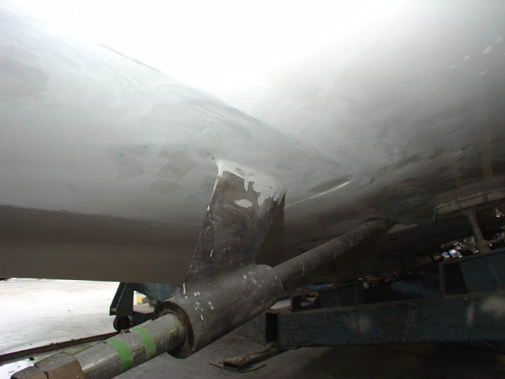

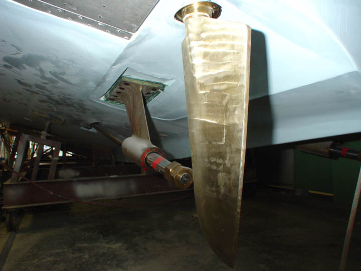

  5. Unlike others in the industry (See the review of the 77 Hatteras Convertible in YF), Bertram chose not to go with cavernous propeller pockets but, rather, with ‘scallops’. This helps lessen the draft but not at the extreme expense of large transmission ratios requiring massive umpteen-bladed propellers. The bronze rudder is notable for it’s very deep chord. Together, with the keel that runs all the way back to the transom, this Bertram should be capable of tracking ramrod- straight in the kinds of following seas that would make your socks roll up & down. The strut is the time-tested Bertram hardware and it’s palm (which is bolted through the hull) is fitted flush into a recess...
  6. ...and then the whole affair is nicely faired into the scallop resulting in very clean water flow.

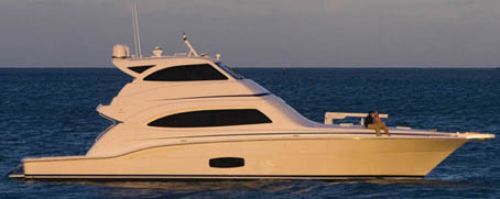

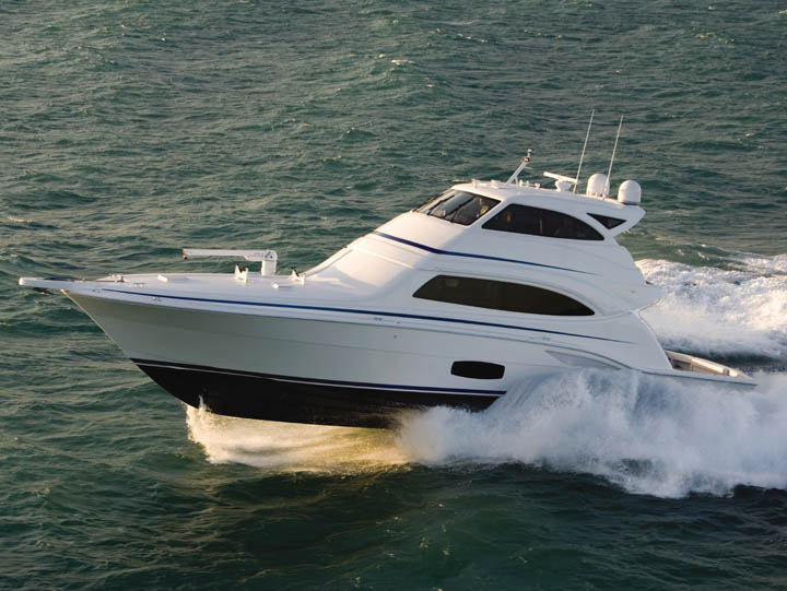

  7. Bertram Yacht, going all the way back to it’s 1960 beginnings, was always noted for headsea & following sea capabilities. Indeed, the first advertising had Dick Bertram at the helm of one of the first 31-footers heading into the jaws of ocean inlet that was rougher than a cob and taking his hands off the wheel. That made believers of those who were used to doing it in the old white-knuckle fashion. How does a company improve on that?
    The Bertram-Ferretti synergy and collaborative engineering efforts result in a superlative 70-footer whose evolution marks the beginnings of a new empire.

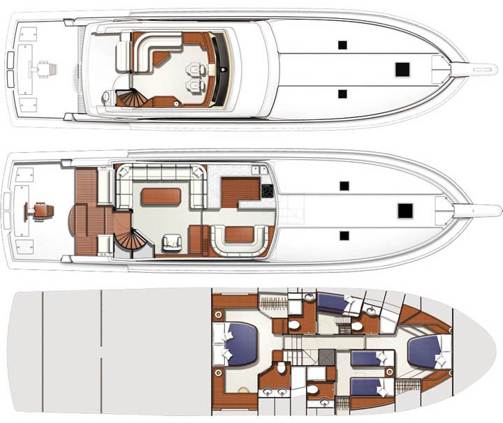

  8. Deck Plans: Top to Bottom...
    1. Bridge Deck
    2. Main Deck
    3. Accommodation Deck
