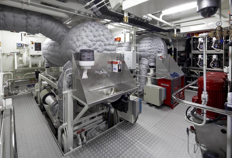

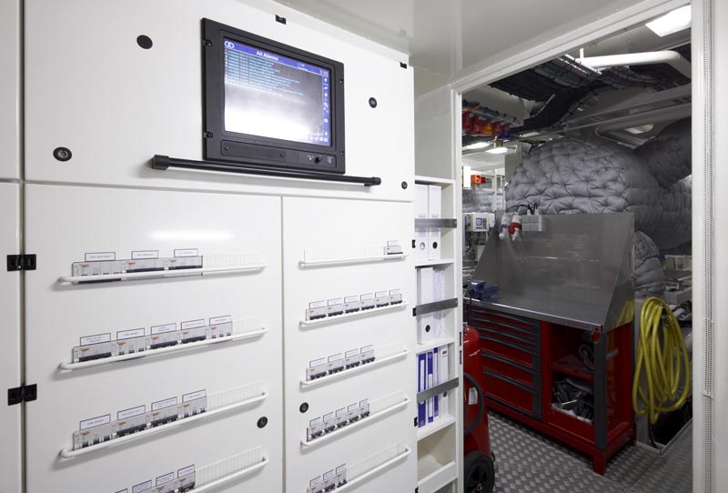

  1. Located between the engine room and the garage, the ship's circuit panel is protected with nerf-bars along each row of switches. The ship's logs and manuals stand ready, secured but easily accessed. In the background, Moonen has gone to great length's to insulate radiant heat from the engine room with complete exhaust covers, making this a working engine room underway. In addition to thermal insulation, Moonen has achieved 33 decibels in the accommodation suites with only one genset running. Underway at 1845 rpm's, a remarkable 54 dB's were recorded. Climma Air keeps the ship cool, but in case things really heat-up, an Eltek fire control system stands ready.
  2. The engine room houses twin workhorse MTU 16v 2000 M60, delivering 800 bkW at 1800 rpm via a set of ZF 4540 gearboxs, twisting 5-blade 1200mm Bronial propellers. Venting the breathe of these horses are Marquip dry w/water injection exhaust systems. With a fuel capacity of 11,830 usg, she’ll deliver 2,300 nm @ 12.5 knots at cruise; max 14.5 knots. For real range, Northlander can cover 5,000 nm at 9 knots. Onboard power is derived from two Northern Lights M1066-A2.51 gensets. At rest or underway, Naiad model 520 zero-speed stabilizers keep rock and roll relegated to music only. Other vitals include 2 Asea shorepower converters, Hamann sewage, two Idromar watermakers and a Tijssen MPA system to keep vitals in check.

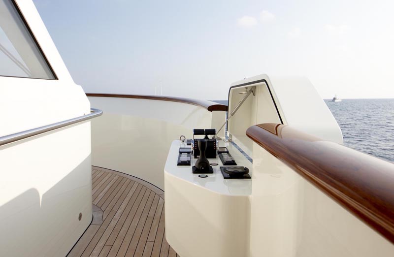

    Wing stations are cleanly integrated into the Portuguese fairing, readily accessible at both beams. For maneuvering, Northlander depends on a Wesmar hydraulic V2-20 bow thruster.

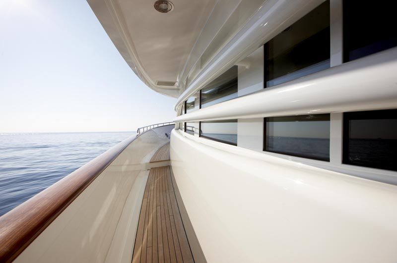

  5. Functional and aesthetic, the M-124's louvered windows not only eliminate the need to "board-up" for big seas, they also double as handrails.

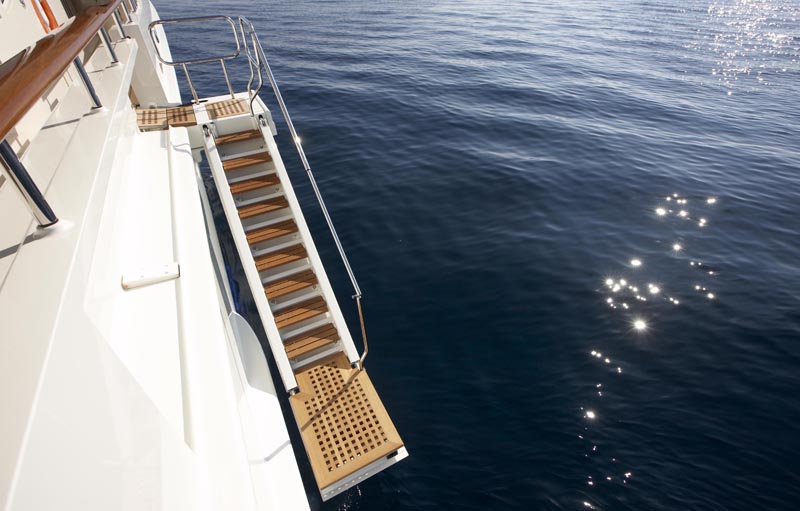

  6. The Cramm Atlantic side passarelle converts hydraulics into mechanics. This articulated system sits flush in hull combing just below the handrail at midship. When activated, the assembly jettisons out from the hull, then the ladder folds out horizontally. From this point, the steps deploy to the level desired. And finally, safety rails are inserted into position.

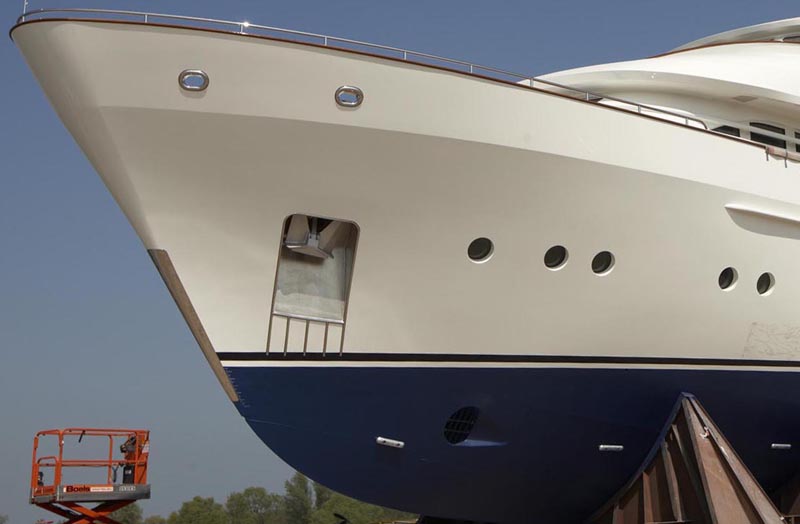

  7. The M-124's anchor pocket gets the KISS award. No problematic doors to contend with, only a pocket deep enough to fully retract the anchor and minimize parasitic drag.

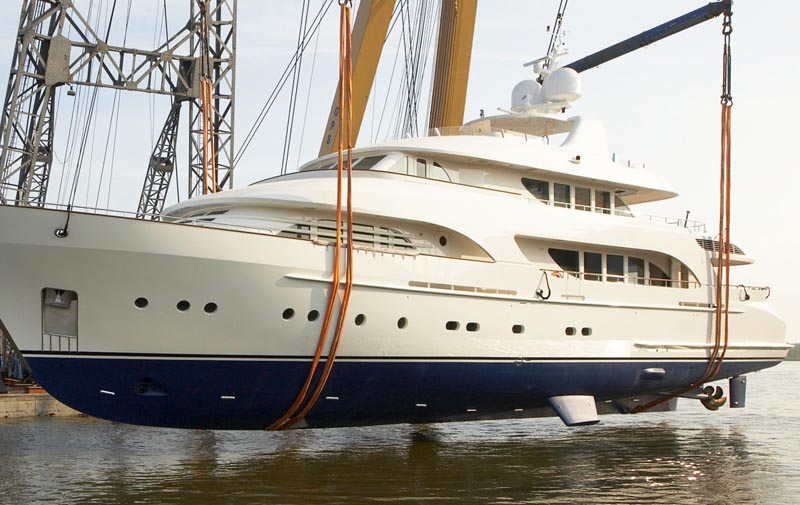

  8. Moonen's emphasis on their "fast-displacement hulls" has struck a balance of displacement hull efficiency and planing hull speed. They accomplish this with a semi-flat, round-bilge hull type that tapers flat at the buttocks, enhancing stability. On the business end, housed propeller shafts minimize turbulence and a ducted keel protect the running gear.

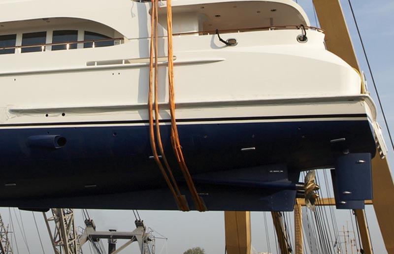

  9. The contrast has been reduced and lightened in this image to further exemplify the hull design and a certain excellence Moonen is achieving in fluid dynamics with foiled stabs, rudders and drive shaft housings that lead to 5-blade helicoil props. Even the anodes follow the flow of water.

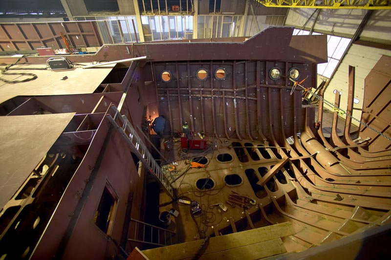

  10. This is the M-124 in the initial building stage. You're looking at - what will eventually become - the crew quarters. Notice the bow thruster tube neatly integrated into the ribs. For engineering types, the beauty is on the bones and this baby's got good calcium.

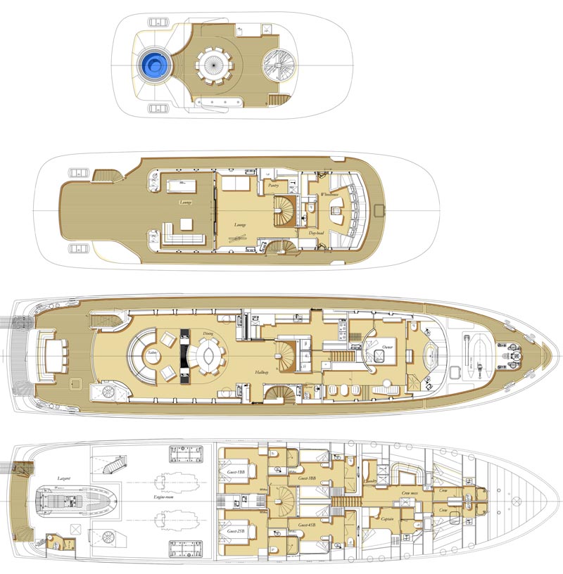

  12. Moonen 124' "Northlander" - Deck Plans
