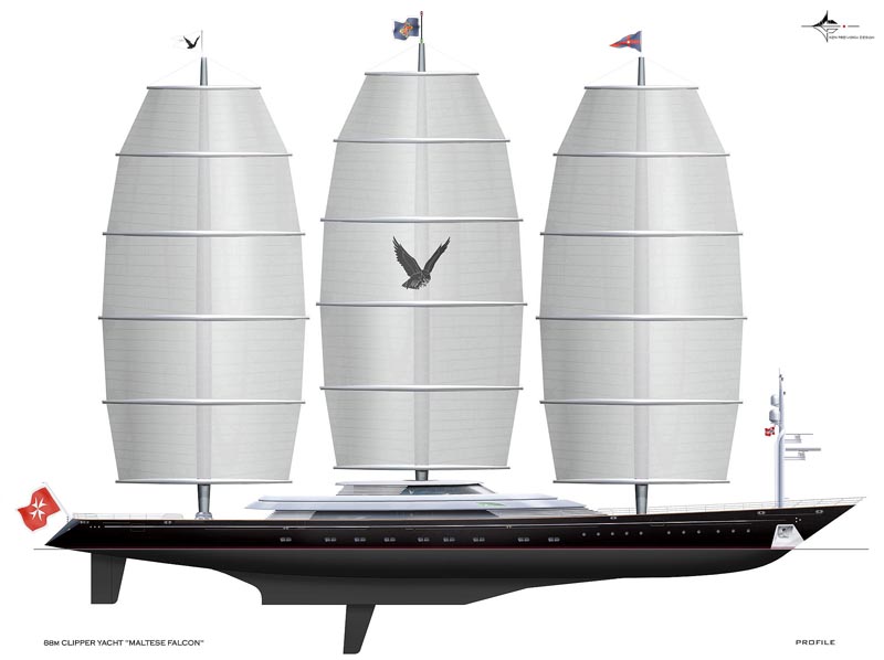

  2. In profile view, the 'Falcon contains many of the same elements as most sailing craft, large or small. The major differences are in the rigging. Each of the three carbon masts are 190’3” (58m) long. Perkins chose Damon Roberts, a practiced Carbospars expert from Insensys, to supervise construction in the Perini yard at Tuzla. Perkins purchased this yard for the project, but later deeded it to Perini.

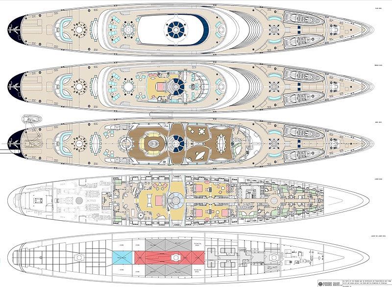

  4. Deck Plans; Top to Bottom -
    1. Plan View
    2. Bridge Deck
    3. Main Deck
    4. Lower Deck
    5. Bilge Deck
