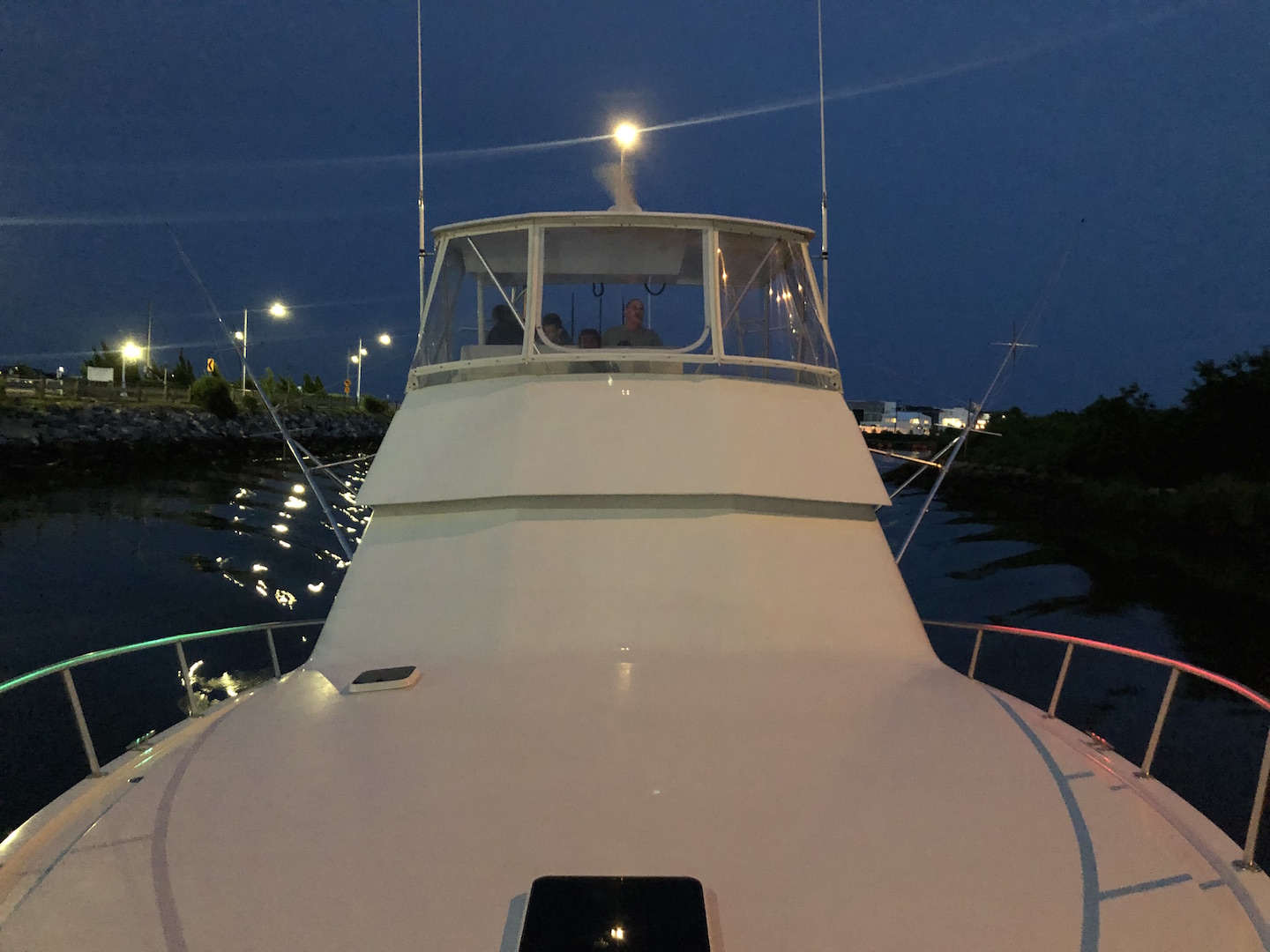

    Coming back from our first (since restoration) trip to the Canyon. Riggers out for the bridge. IMG-4698.jpeg
