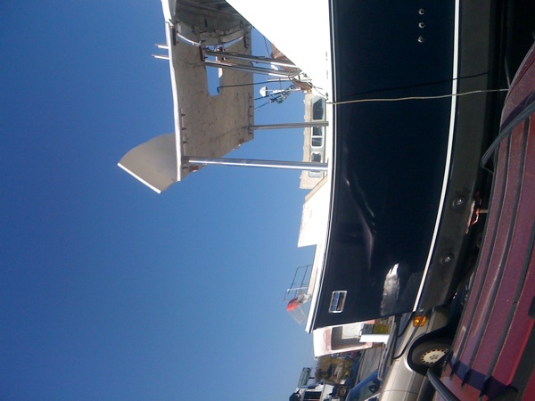

    daina

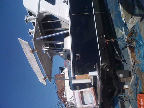

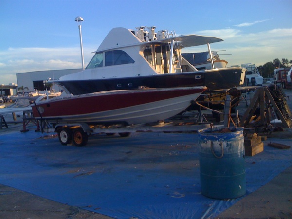

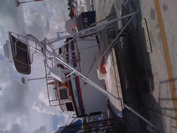

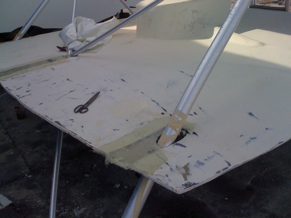

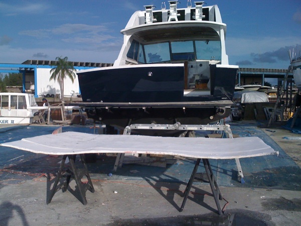

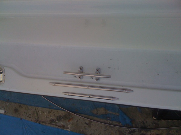

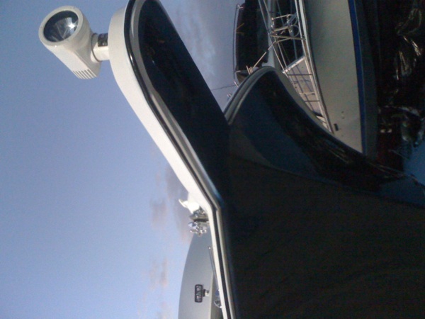

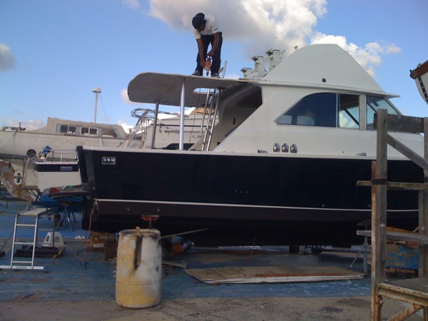

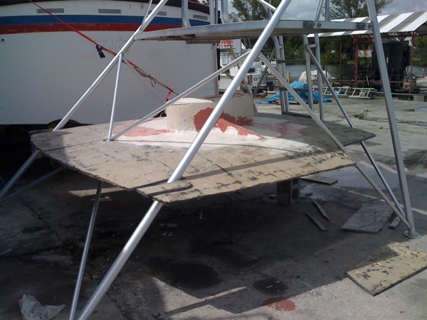

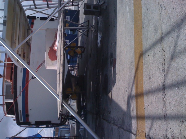

    fitting the tower hard top
    photo 1 shows the way we notched the top to slip thro the front tower tubes, if you look close you can see the center is filled with what was removed ll the pieces will be glassed in for final install. the 2 photo gives you an idea where the radar will end up and the 3'rd photo you can see the way the mounting style will allow the hard top to over hang the tubing with out having a two piece tower....

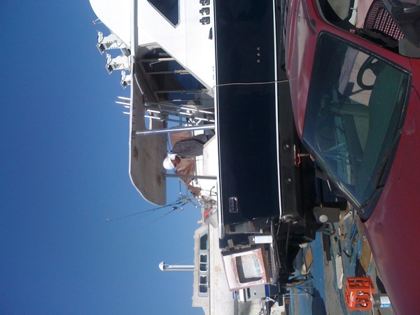

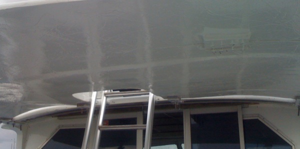

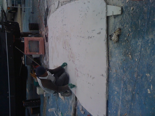

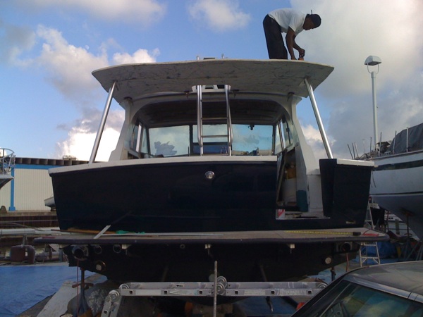

    getting dussty with the cockpit hardtop
    sanding is fun:eek:
    first shot is of tommy filling pin holes the 2'nd photo show the two top we are messing with. the 3'rd shot is of the final sand b4 hi build primer.

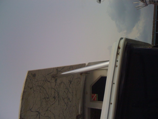

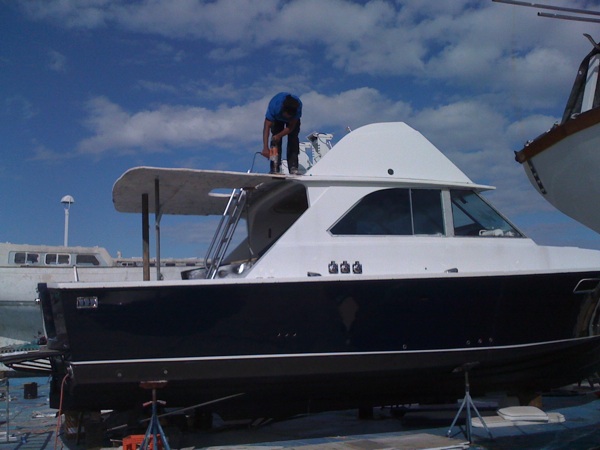

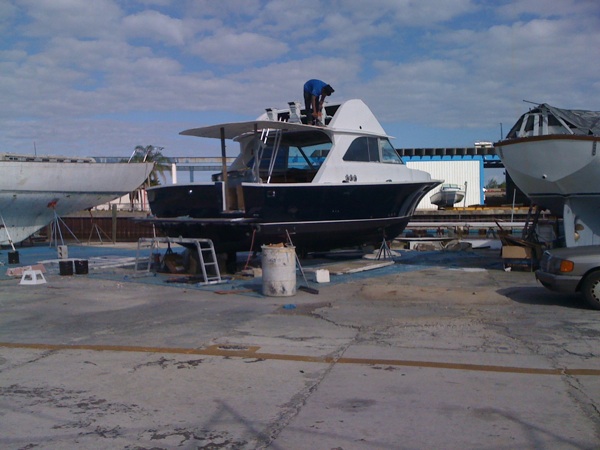

    in stalling the top
    photo 1 is how I patched the cuts in the tuna tower hard top. photo 2 & 3 is the cockpit hard top half installed bolted to the salon roof and held up by 2x4 till the pipe is welded.

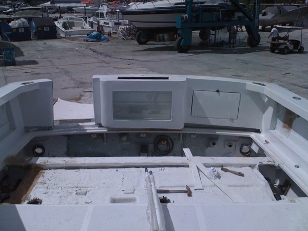

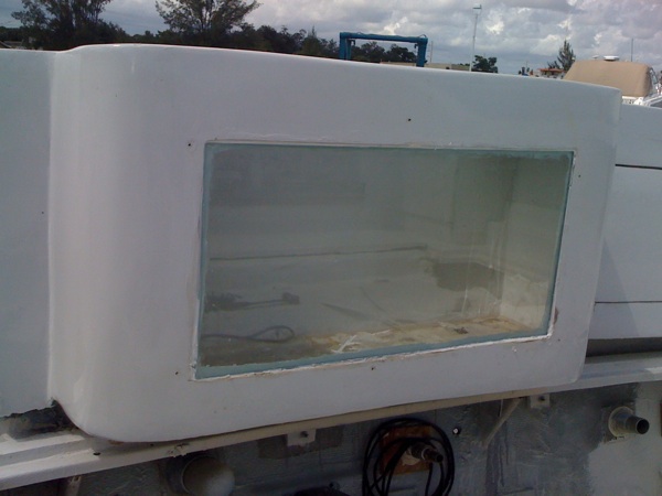

    here fishy fishy I see you
    so photo 1 & 2 show the glass window in the built in bate tank it will be lit with and ocean led....:)

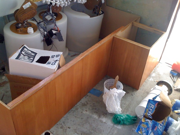

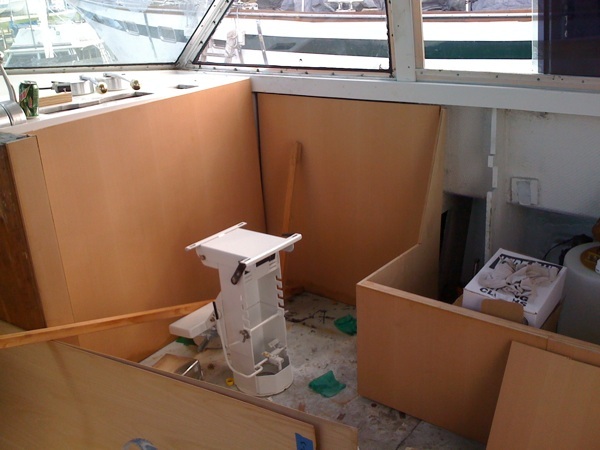

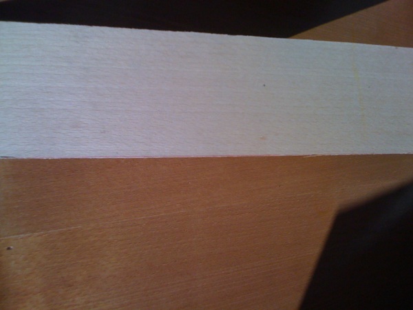

    finaly the cabin
    the first two photos show the start of the build and the unfinished mahogany... the last photo show the unfinished and tow coat of 5 to 1 epoxy

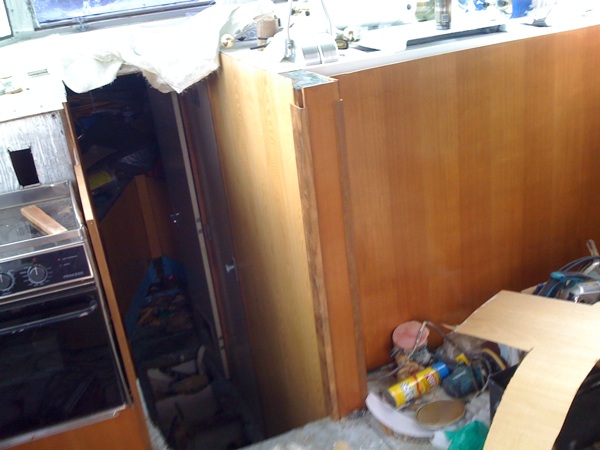

    epoxy it all
    nothing will ever bend or even if that window gets left open...

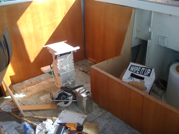

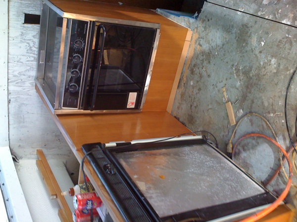

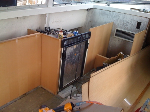

    gimbeling the stove
    in photo 1,,, I removed the trim on the side of the seaward stove & gimbeled the stove you can also see the teak trim going in and the quilted maple down stars in the birth the 2nd photo is a close up of the maple..

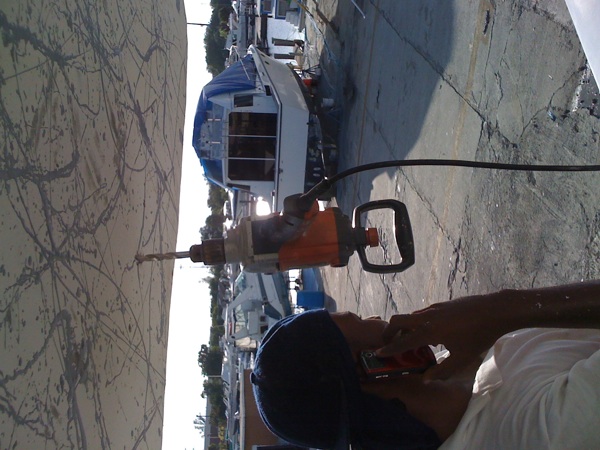

    daina
    finishing up the cockpit hard top
    so shot one shows why not to use a spade drill to drill holes ended up braking my hand when the bit stuck:),, photo 2 and 3 show the legs that support the back of the hard top...

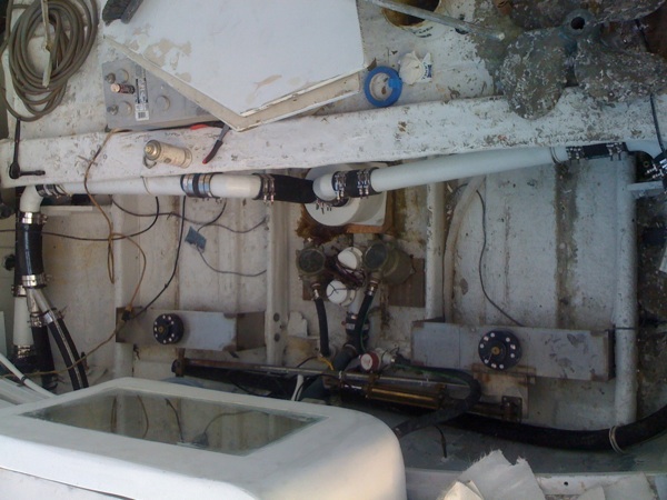

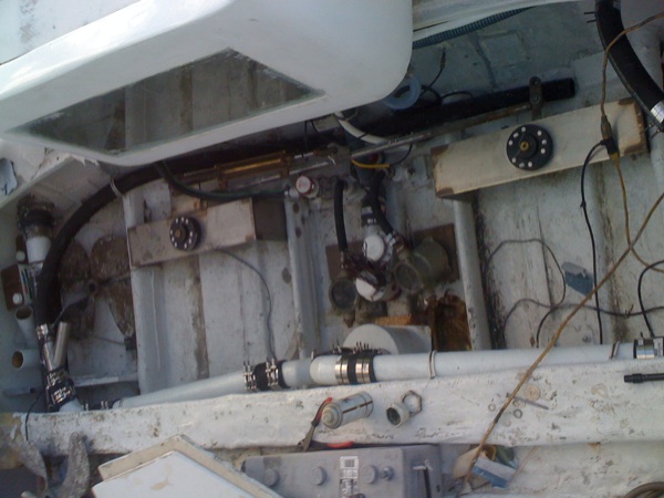

    Time for the yacht surveyor
    well I need to put some new photos up... I had the bertram bottom and seacocks and pluming checked by a yacht surveyor, kinda a 50% survey so I can finish up dock side.. All he rely had to say was there were no voids in the hull :cool: and to make a sticker for the factory fuel tank listing a build date. We chatted a little about how I was going to run the ac/dc system and he was on his way... I stressed it for a week but turns out my friends have been harder on me about how to build this boat then the surveyor, my friends do work on mega yachts and are well payed so there is no real surprise.

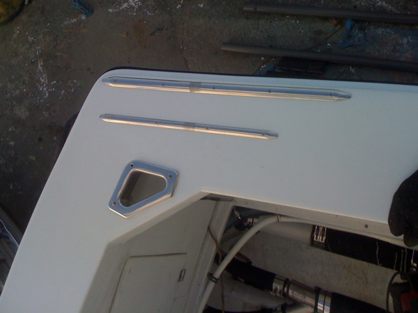

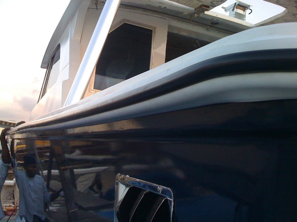

    here's a start... rub rail I went pvc with rubber insert.. stainless is nice but this will not dent,,,,

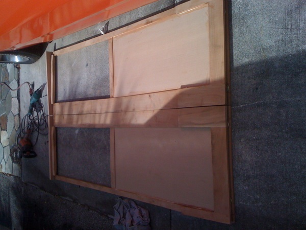

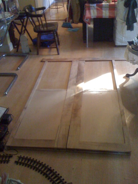

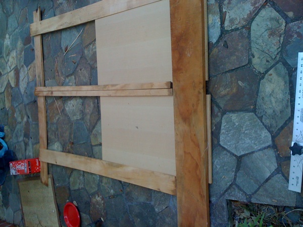

    mahogany salon door
    start to glue up... the top is not glued till the glass is installed

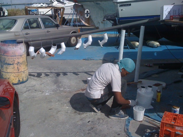

    plummin the last holes in here
    there are 2 gen's going in her so there's a fun little system set up....

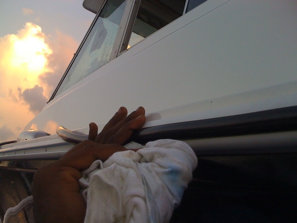

    touch up paint...
    shiny, shiny hard top....
