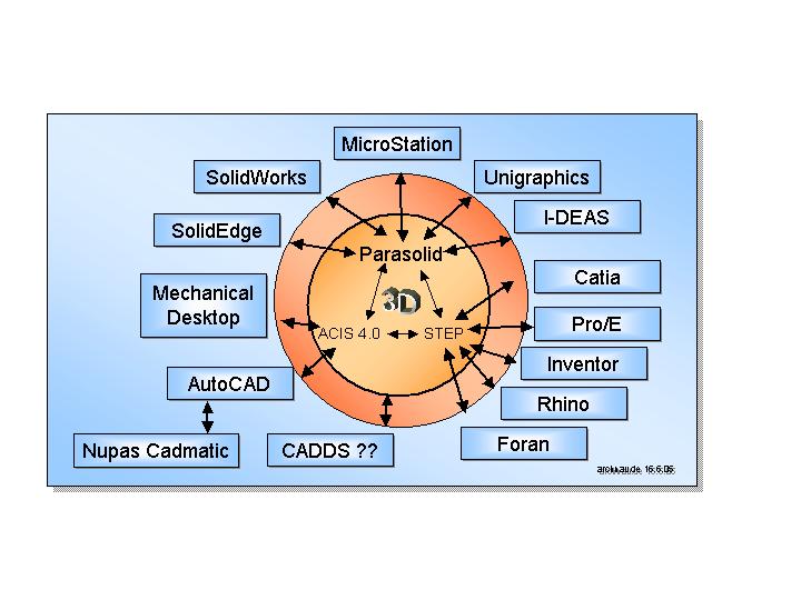

    Today it is hard to build 3D-models from the early beginning and to keep them through the whole shipbuilding process, because of the missing interfaces between the different 3D CAD-Systems, the missing 3D-equipment models from sub suppliers(all you can get are normally 2D-dxf files) and the missing ability to handle very complex and large 3D-models in a smooth way.
    But never the less before Detail Design begins the following work has to be carried out:

    All these activities have to take the same ship and the specific conditions at the shipyard into account. These plans are often made too late, are incomplete, faulty, contradictory or too inaccurate. The reason for this is the fact, that everybody must work independently and there is no common product and production model to guarantee the transparency of the information. These partly incompatible plans finally lead to considerable disturbances and much higher costs than necessary.
    The EDP development on most shipyards has gone into the following direction:
    The amount of different software packages has increased
    The number of data files has increased
    The number of inaccurate plans has increased.
    As a new starting point we are trying to build up a 3D-model store under
    http://www.boatdesign.net/gallery/showgallery.php/cat/3054
    As an enclosure you find a picture how to the handle the 3D-interfaces between the CAD-systems in the best way. For the Rhino people: You should work normally via Step, except for the export towards Autocad. Use here Acis 4.0. If you have the models in the three formats Parasolid (.x_t), ACIS (.sat) and STEP (.stp) available you can act with them in most CAD-Systems like native files. With .igs you get normally a lot of problems.

    That's also for us the most important point for the long run. As mentioned already if you have the models in the three formats Parasolid (.x_t), ACIS (.sat) and STEP (.stp) available you can act with them in most CAD-Systems like native files. For the Rhino people: You should work normally via Step, except for the export towards AutoCAD. Use here Acis 4.0.
    For UGS the in and output should be .x_t, because the system is based on Parasolid, further on beside that, you should produce a .stp (AP214) file. On the internet there is an tool available to translate files between .x_t, .stp and .sat up to 5MB http://www.steptools.com/translate
