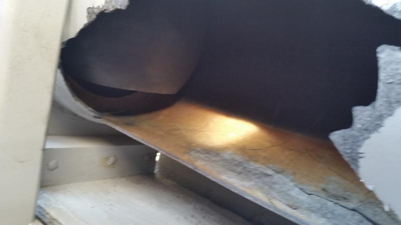

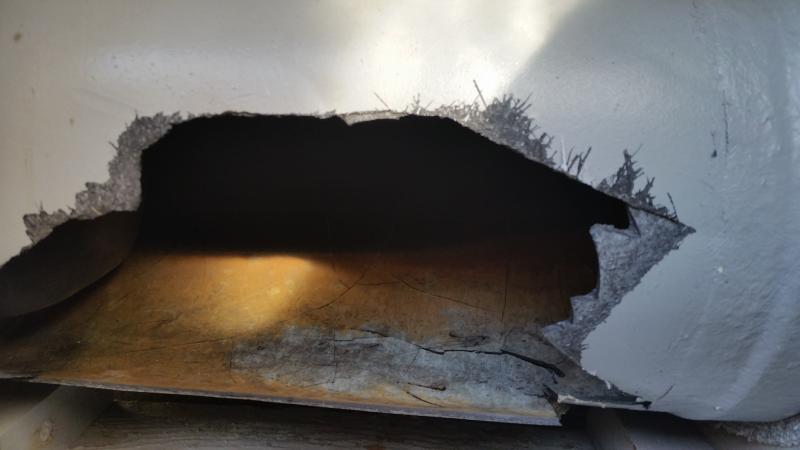

    Pictures of muffler
    Port side muffler.
  3. Capt J
    14,842
    That looks like it's been stress cracked a long time.....almost like it was damaged previously from a poor winterization or something.....
  4. NEO56
    NEO56 Member
    May 2, 2014
    656
    Miami
    I agree Capt J, that was years in the making, the serrated edges clearly make that case, if it was a back pressure explosion it would have been a much cleaner hole, that is a fatigued piece of pipe.

    Sure looks like a failed seam at the bottom.

    14,842
    My theory is the exhaust was weak noticed by the old stress cracking on the inside of it. Something had floated into the exhaust causing excessive back pressure (dead animal, coconut, etc.). When the engine started there was excessive back pressure, and the bang was the side of the muffler exploding. There was no way a piece like that blew off without creating a bang noise.....sort of like when you fill a plastic bag or ballon with air and then smash it cause it to explode.

    Beaufort, NC
    So re-reading the OP, this event occurred shortly after launch and preparing for a sea trial. Wonder when the last start up occurred. {later post says a few days earlier?} Was the boat stored on land or in the water, previously? Not an engineer, but that looks like an inside to outside failure. What else other than back pressure can do that? If it were in the water for a while, you'd think, ok, the engines hadn't been started for a while so something went up the exhaust and clogged it. On the other hand the boat had just been launched a few days earlier or at least started a few days earlier. How did they move it to the slip, if they did? No answers, just questions from here.
