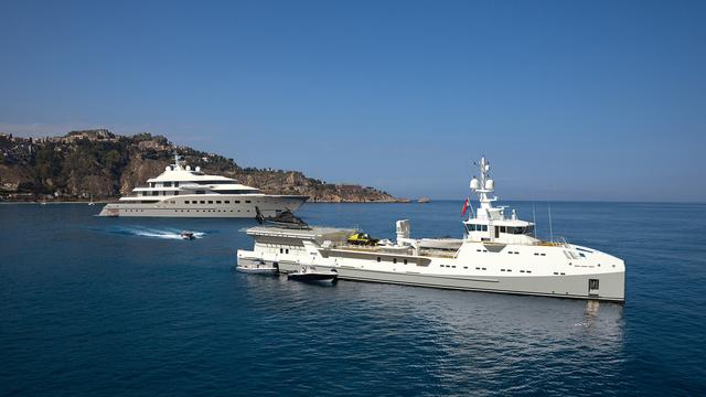

    I personally believe, the Fast Yacht Support is a dead end road. No space below deck, very expensive to operate (4 pretty big engines !!!), rides very wet, rolls allready on a wet lawn and as one owner of a FYS just found out, has a very bad resale value.

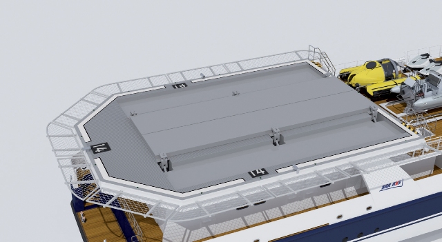

    Not sure if this suggests anything Ken... but it is pictured in this render with a LE272.

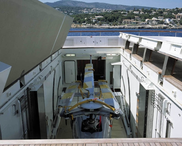

    This was the Helo hangar of ILONA prior to the accident and her modification. The mechanism being as complicated as a human brain could come up with. Remember the shaft length was shorter than the fuselage length of the Helo.

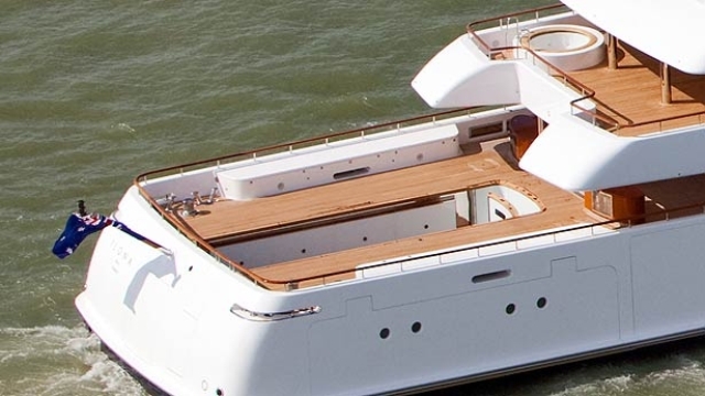

    And this is the pool arrangement after the modification.
    Pretty dangerous too without water in it.

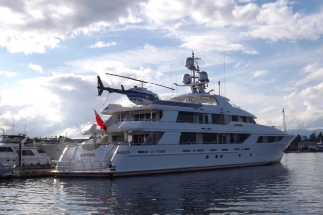

    I have to agree with Fishtigua. Except for a true Explorer "Yacht" like Octopus, which is really used as such, carrying the helo permanently on the yacht is mostly boastfulness (showboating). Transfering guests or crew / cargo can in most cases be done by chartered, landbased helicopter. But then you have to work with an reliable agent, who is making sure, the aircrew has the required skills and proficiency, is familiar with the landing pad and its obstructions AND the specially trained ships crew handling the visiting helicopter is familiar with (and certified for) the type of aircraft. On commercially used yachts, this is mandated by rule anyhow. For all practical purposes, a commercial helicopter pilot is concidered being a proficient pilot (as pilot in command) for offshore operation or mountain flying with about 2.500 flying hours and a minimum of 500 hours on the specific type of a ircraft. Even having this amount of PIC flying hours on rotary aircraft, I would not concider myself proficient enough, to be landing on one of those small inofficial landing pads on some yachts.
    A well known large yacht, based in the Med, has a Sikorski s-76 helicopter permanently stationed on board, whenever the yacht leaves the harbour. One of its former pilots works for us now. His main missions were transfer rides to a nearby airport where the large aircraft of the owner was on stby, reconnaissance flights for nice and quiet beaches and mainly as the ultimate method of escape (!!!). The ship had once a little fire on board and the owner and its family could be evacuated to shore within minutes. This capability became a mandatory procedure on that ship from that day on.
    A safe touch and go landing pad can be realized on a 200 ft+ yacht by converting a sundeck, making a sundeck convertible or using an enclosed forecasle (Quattroelle). But carrying the helo on that sundeck permanently (except for ferry without guests, when crossing the pond), takes away too much valuable decksspace. But adding refuelling capability to this yacht is a nightmare, as far as safety measurements and crew requirements are concerned. And "parking" a helicopter out in the inviroment on deck is a nightmare for the helicopter maintenance.

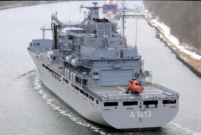

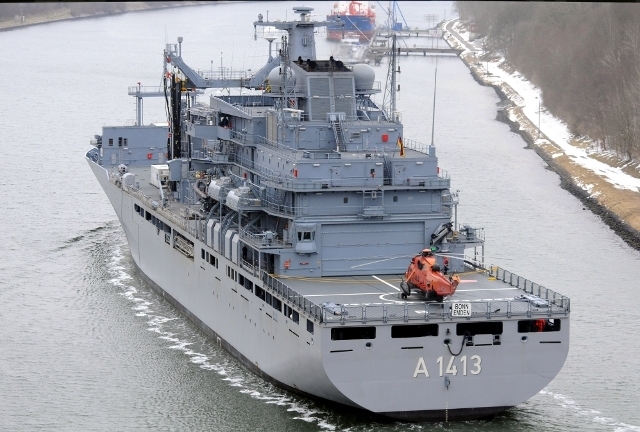

    The best approach solving most if not all problems associated with helicopter operation on yachts is a shadow for the the yacht. But not this "fast yacht support" concept, which is basically only trying to find one more market for an badly selling offshore transfer vessel concept. As I have said before, in my personal opinion, the best shadow for a yacht is a seaworthy, proven, converted cargo vessel. All toys, spare crew, tender and its crew, the helicopter or even a fixed wing amphibious aircraft with a certified enviroment and ample of bunker and supply can live and be carried on that shadow.
    One could buy and convert TWO preowned 400 ft cargo vessels into perfect shadows for the price of one Damen FYS 6911 even without this silly hangar. And even operating those converted cargo vessels would be cheaper than operating a FYS. And by removing some tender and toys from the yacht would free ample of space for much better purposes on that yacht or the yacht could be designed smaller, with all its advantages.
    The Navy knows how to build a shadow. Just imagine half the size and without all this expensive military spec / equipment and taking a preowned cargo vessel as the starting point.

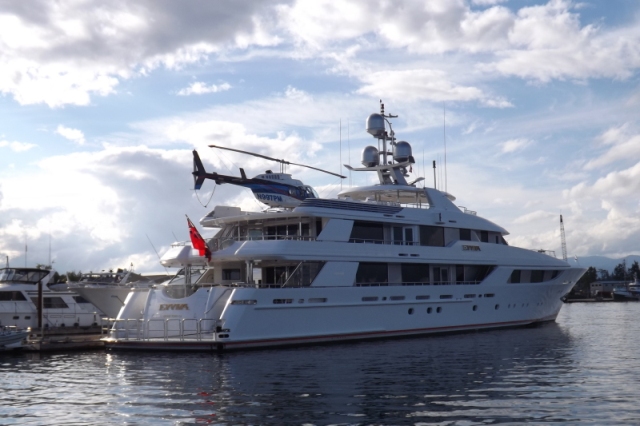

    I disagree with you, and am slightly offended on my boss' behalf. Evviva has been carrying a helicopter for the owners' personal use for twenty-four years. The last thing they are is pretentious, and really prefer not to draw attention to themselves. In our case, there is a great sense of comfort in knowing and trusting the aircraft, maintenance, and pilot. While chartering would be more cost effective, it would not come with the sense of security that our boss gets from owning his own craft, and knowing his flight crew and AP (mechanic). I suppose the same could be said for private jets and yachts too. We have not yet even mentioned the convenience of having your pilot on standby, rather than having to order a pickup from a shore based charter company.
    Our Bell 407 is 12 years old, and has primarily lived on deck during cruising seasons. Most recently it crossed the pacific on deck, and our AP was very pleasantly surprised with how well it weathered the crossing. I am not by any means an expert, but according to our pilot and mechanic it's in remarkable condition. So much so, that we couldn't justify the purchase of a new machine when the discussion came up last year.

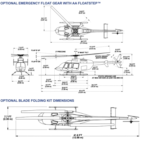

    Look at the measurements of our example, the widely used Bell 407
    If you add the neccessary walk around space around the helo with folded rotor blades, you will come up with with a pretty large hangar. That amount of space is hard to find on a yacht. The biggest problem is the height as it will take two decks. On the Bell 206-4 things are a bit easier as the only two blades do not need to be folded. Removing rotor blades can be painfull, as most helicopters require a balance run and some more inspections after reinstalling the blades.
