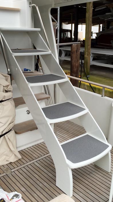

    Owner of 2014 Beneteau Swift 44 purchased December 2014. We have put 300 hours on her and have had added several custom features in the year we have owned her- including a beautiful set of custom bridge stairs allowing our 90 lb German shepherd "Kobe" to join us with ease on the fly bridge. We have corrected several problems that we have encountered even though she was purchased new and have learned a few Swift 44 tricks along the way.

    The stairs are great and removable to get at lazarett below. Made of a cell material with gel it coating. Weighs 30lbs. We pretty much Kearney them in place all the time. I'll try to upload a pic for anyone interested.

    Congratulation on the Beneteau Swift 44
    I am very happy with my boat
    March 15 I am going to KEY WEST and in April I will be in the TORTUGAS returning to Ft Lauderdale April 28
    send me a picture of the modification you did in order that your dog can come to the bridge I have a English Mastiff that look at me sad wend I go there and I can not take him up because the stairs are not compatible for big dogs.

    I found your stairs
  13. Rick L
    Rick L New Member
    Feb 11, 2016
    13
    Jacksonville, Florida
    Glad you found it! If you want more info or pics let me know. Our dog now is used to them and goes up and down on his own.
