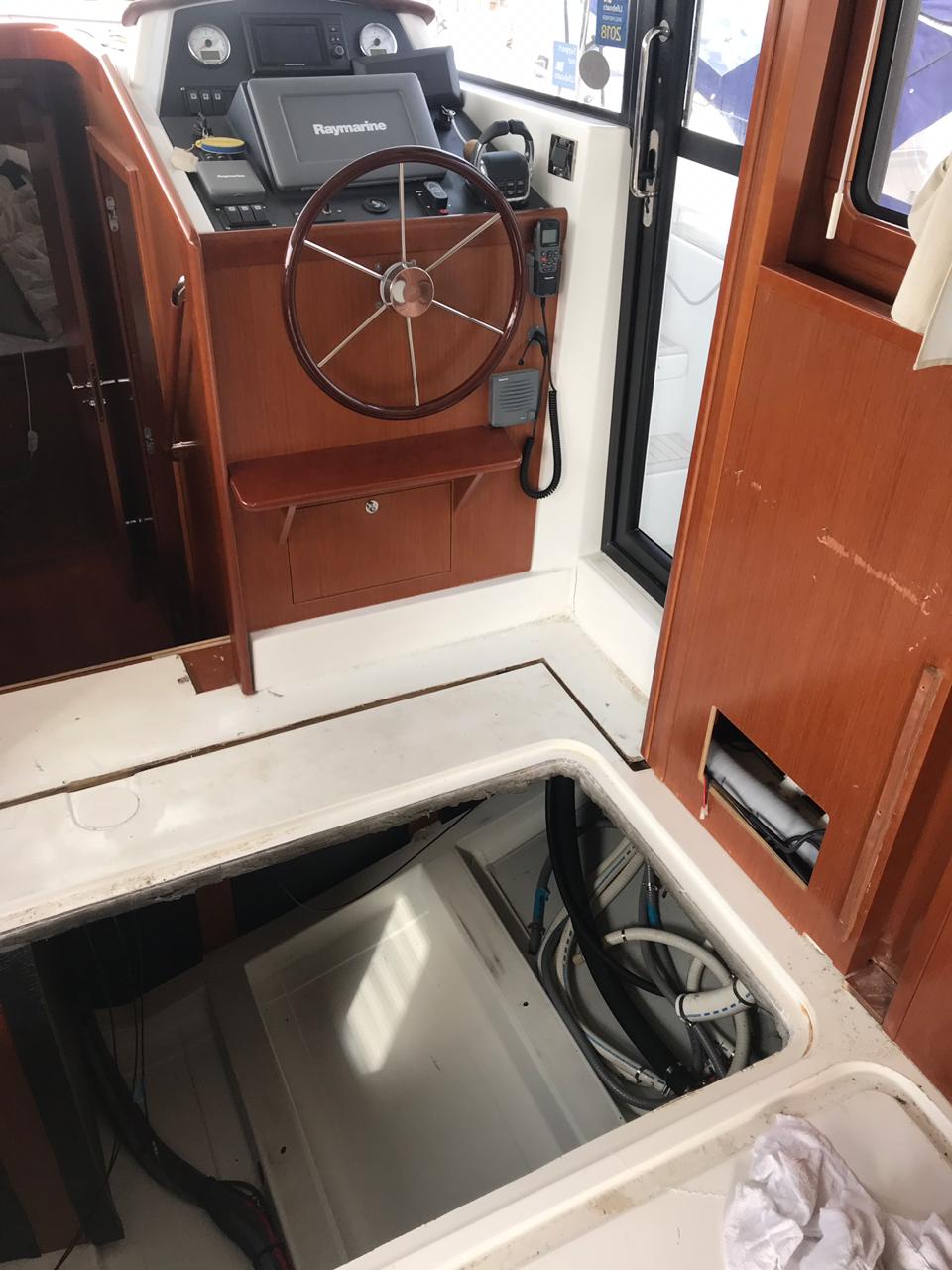

    The boat is back in the water now. Overall the cost was about £8k. The job involved removing the sofa and downstairs helm seat and cutting a hole in the floor then taking out all water tanks and pumps before removing and replacing both fuel tanks. The cause was lack of weld material at a small spot on the seam so it was covered under my latent defect clause. Nevertheless I took the opportunity to upgrade to SS tanks. Just brought her back over the Channel and I still love her. See photo

    Paul, Wow, that was a major job and a pain to deal with. Thanks for sharing, so far I have not had any tank issues on my 2011 ST34.
