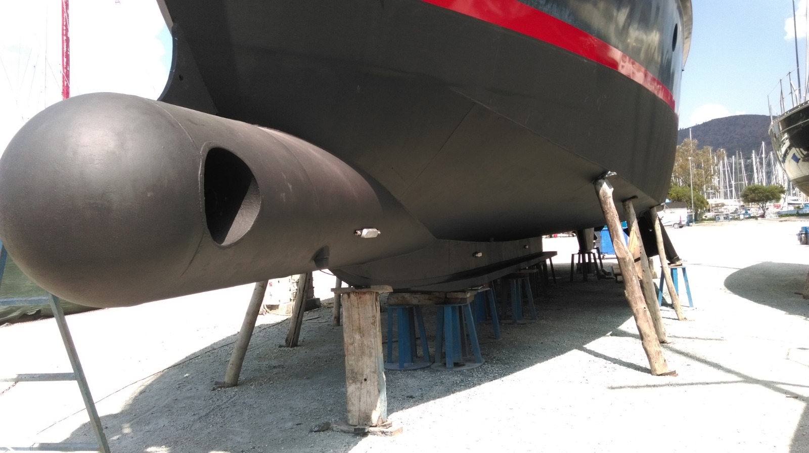

    Hi Judy,
    I am one of the 75/81 (exactly same hull size) owners and have never had any of the problems mentioned. Neither stability nor water on the decks other than normal wave splashing.
    Devils Advocate is known for its utmost and nearly exaggerated seaworthiness to the degree that if you asked CROSSMED (French national Coast Guard) who we are, they would say that our ship sails when no other does and has in the past helped in search and rescue operations in gale force winds.
    Our only worry in the past has been that through storms dirt in the daytanks might affect the fuel flow so that we installed a professional REVERSO fuel polisher to keep our fuel clean, as well as clean all 8 fuel tanks on a semi regular basis.
    Damages of the past? Once in a storm, a large television from the library fell out of the cupboard and once we lost valuable porcelain also from inside a cupboard.
    We have also learnt to properly fasten our tender as this once moved dangerously in another storm. None of this has anything to do with the quality of Cape Horn Yachts and has more to do with us on board preparing properly for bad seas.
    In my experience and having been on various 'so called' trawlers such as Nordhavn which are made of laminated fiberglass and can hardly even compare to a Cape Horn, my Cape Horn is a ship for all seas and not a plastic fantastic yacht which I would never take out in a strong gale.
    Yes, she is heavy but that makes her very stable in adverse weather and a pleasure to handle her. She is not affected by wind as others are when mooring 'stern-to' and her Bruce anchor is so big and strong that we have never ever dragged an inch whilst I have seen large 150' and more yachts having real problems.
    All in all it can be said, that maybe flashier boats exist for showing off , but if you are looking for a real ship to travel large distances with on in all safety, then sadly only 17 Cape Horns exist and not many other similar quality vessels from other ship builders to chose from..
