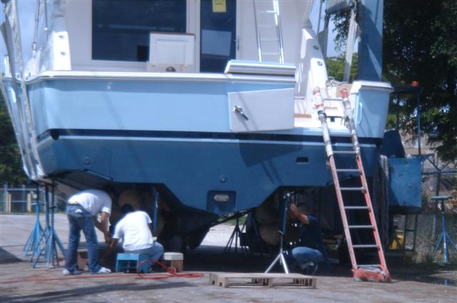

    I was on the prototype as well. You forget to mention the boat doesn't turn at speed (it just lays over on one side) and that at speed in straight line it porpoises to the point of madness. This isn't the first 63 to suffer lamination issues, there have been several more (including the first 63 Moppie which ripped one of the engines off the stringers), this is just the first one that the factory wasn't able to cover up. I also wouldn't lay the blame with the Ferretti ownership, Bertrams have been built like crap for years. I have a 1995 30 Moppie whose hull sides are cored with balsa, this would be fine if the factory had properly treated the areas of the hull side that they penetrated (vents, thru hulls etc), but since they didn't literally the entire hull sides are full of rotted nasty old balsa. You would think they would have learned after the disaster with the 72! Essentially IMO Bertram has been operating in some form of financial distress since the early 90's, when operating under those circumstances its hard to keep quality control where it should be. Since the Ferretti ownership they've done nothing but build designs that their target audience doesn't care for (the sales figures prove my point) and using questionable engineering which basically try to emulate motor yacht thinking into a sportfisherman. Perfect example is the poster who said the 57 was a wet ride, that would be hard to believe considering the 57 is the old Napier designed 54 stretched 3 feet, but with Zuccon groups styling and that goofy forward mounted fuel tank, they've managed to move the LCG forward enough to ruin the boats ride!
    IMO its time for an ownership (and ideology change) at bertram otherwise they will end up going the way of other old great names (IE Chris Craft)...
  13. YachtForums
    20,856
    I experienced NO porpoising. The boat ran properly trimmed. As for turning... we entered a high speed, 180 degree hard turn inside Government Cut at around 30 knots that was completely uneventful. I had NO problem with the handling of the boat. However, I heard through the grapevine that it's larger sibling, the 67', was a pogo stick. Can't confirm, wasn't there.
    I need to divulge something... Dick Bertram was a friend of the family. So was Moppie. If he was alive today to see this non-sense, it would become a non-issue. Dick was instrumental in guiding me toward a career in Naval development. He introduced me to Frank Denison and Jack Hargrave. Because of this, I feel a certain kinship... responsibility if you will... to speak up because he can't.

    That must have been after the third or fourth set of rudders. The initial sea trials before the lauderdale show were horrible, the boat would bank into the turn then just lay on its side. Here's a peek at that wonderful bottom...
  17. Capt J
    14,842
    I can see exactly how that boat can lay on one side of the keel in a turn and the keel looks a bit wide , there isn't enough flat area in the stern IMO. Why wouldn't they re-use the origional 54' hull with newer lines? It rode great, was very fast, and great. (I ran a 54' with a hardtop with 12v71's that had 4600 origional hours and it ran 30 knots at 1850 rpms.)
    It's like the first 58' HATT SF's way back, they were so bad you'd literally have to tie yourself to the tower or the boat would eject you in a beam sea. Then they added that chine that runs along the entire hull side to fix it.
