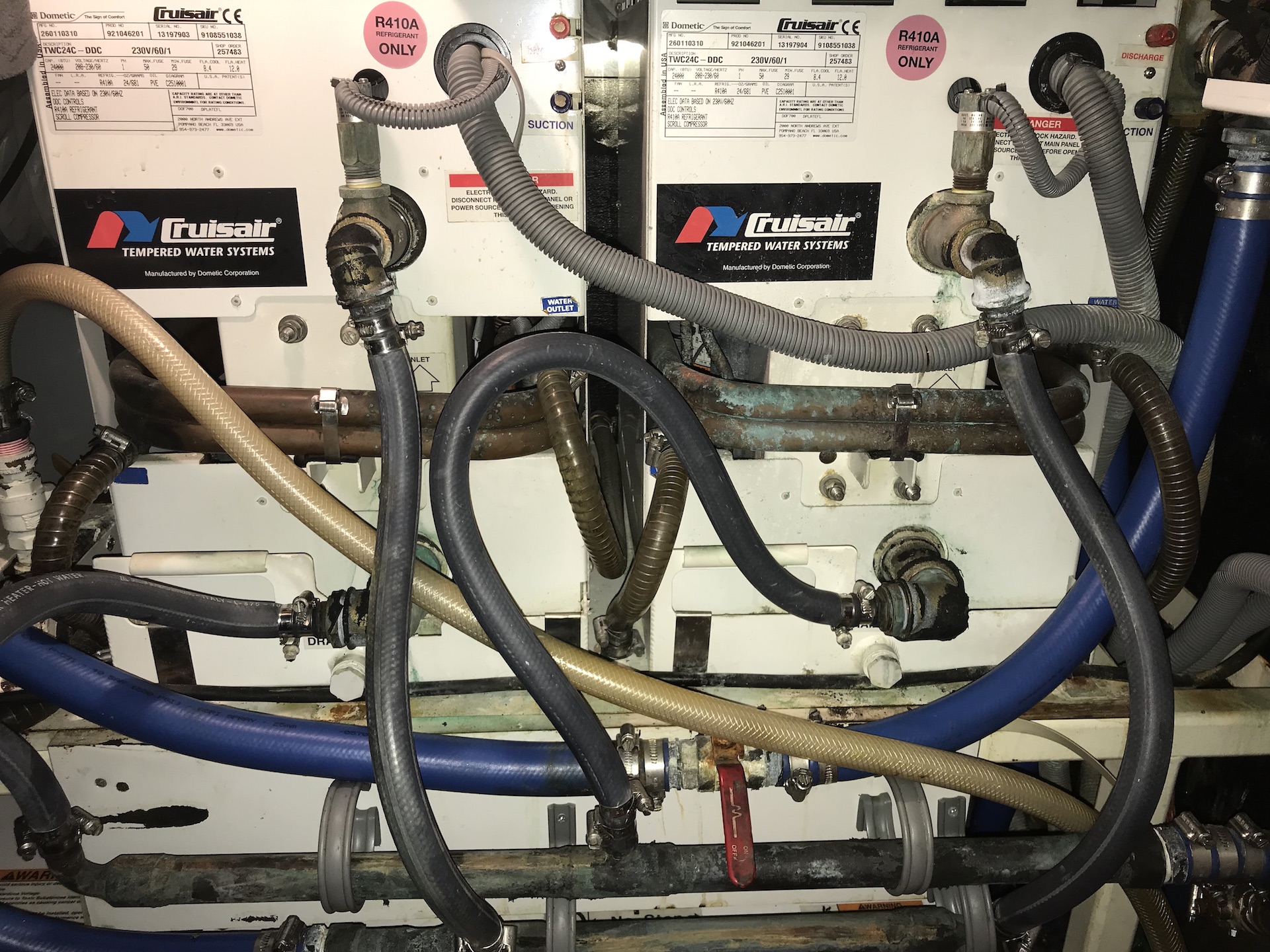

    Ok Everybody swallow their coffee, beer, wine, or whatever, [I don't want you to spray it out] and check this out.
    The boat has a potable water hose connected from the fresh water pump to the pressure switch on the circulating pump. Although the tech hasn't tested the chill water side, we expect to see only water, not an anti-freeze/glycol mix. The tech guy is more apoplectic than me. . . Me? I'm having a serious WTF moment!! So, I've been running the ac system with that good quality South-Florida & Central Florida drinking water? That might explain some of the corrosion we are seeing on fittings.
    I'm going to put out these flames with some serious grog!! Y'know, it's 17:00hrs somewhere..

    Its a normal plumbing circuit to have chiller loop "make up water" or the vessels pressurized fresh water system plumbed into the chilled water circuit. If the chiller loop was commissioned correctly with Food grade glycol at inception than it will still remain in the chilled water loop unless the system has had a constant leak and make up water was used extensively. The dumbed down systems have a auto regulator on the make up side of the loop and over time the regulator will fail allowing your chilled water loop to over pressurize and blow cruddy loop water all over the place. Murphys law...

    If you have a connection between your fresh water system and the chilled water loop, common on cruisair, there should be a valve that will only be opened to top off the loop. I rarely have to do it, maybe twice a year. I was told 15 PSI is ideal. No more
    I was also told that in locations where freeze isn’t a concern, pure water is fine. No need for glycol but I am sure others may feel differently
    On my Hatteras the Flagship system uses water only. Pressure and level is maintained with a small 5 gallon tank located at the highest point in the system. Simple. It works

    The Glycol in your chiller loop doesn't care about the geographical location of the vessel but rather helps lower the freeze point of the loop from your chiller plates or if your freeze up controls go south on you. Glycol also helps thermal transfer or conductance of the loop from the chiller plates.

    This, and I haven't been on a yacht with chillers that didn't slowly lose water somewhere in the chiller loop and make up water needed to be added every 1-3 months. With so many hose connections and hoses routed throughout the entire boat, they tend to leak a little at a connection somewhere and considering most connections are hidden inside insulation, it's hard to find. IF you have a leak so large that you're constantly adding make up water, then you have a problem and need to find the leak.

    Update on the project: According to manufacturer, the original installation was done at factory, with the original purchaser of the vessel specifying Dometic. However, as Cap'n J opined, LEAKS, LEAKS, LEAKS!!! Leaks at the 6 air handlers where the hose is clamped to the supply & return nipples. Leaks at T-connections in the flexible HEP2O chiller lines. Leaks on the chill-water pump connection to the potable make-up water.
    Apparently the original raw-water pump was replaced with a over-capacity SW pump. Current pump is 20gph, but according to Dometic the system requires only 12-16gph. Dometic says the over-capacity is causing premature wear on the chiller units (2ea TWC24).
    Additionally, according to Dometic the system should be running 1" trunk lines, with 3/4" going to the AH's. What I have is 22mm and 15mm HEP2O. So as I learn that Dometic is using inside diameter, and HEP2O is outside diameter, it becomes pretty obvious that the lines are too narrow. 22mm OD is 18.8mm ID, or .7401575 (using my conversion app on phone - doesn't everyone want 7 significant digits in the solution??LOL); so I'm at least 25% undersized on the trunk lines!!
    This is getting ugly - - FAST!!! As the third owner, I'm dubious of any warranty/legal claims against the manufacturer for reimbursement for replacing components and water lines.

    Definitely a crappy instal. Rule nr 1 follow the manufacturer recomendation for pumps and hose size. That s what I did when i self installed the Flagship chiller system on my 53. I had a couple of slow leaks at manifolds in the ER, quickly resolved, but never at the air handlers. If an installer can’t use the right barb and hoses on the chiller water loop hopefully they didn’t screw up the sea water side as it will sink the boat

    The DOMETICMEISTERS have set me up with the proper schematic. 1.25" Chiller supply & return lines to first split. Thence 1 inch supply & return lines, with .75 inch running to the AHU's. I'll be replacing the two 24K BTU's with a single 12-48K variable unit, and new AHU's all around. The ball valves in the system will be 316 stainless, not the crappy one's with ferrous metal fasteners on the handles. And I'm not going to have 1" chiller outlet water reduced to 3/4" and then enlarged to a 1" manifold, before being reduced again to 3/4" as it is now!!! Worst piping I've ever seen-and I'm not an engineer!!
