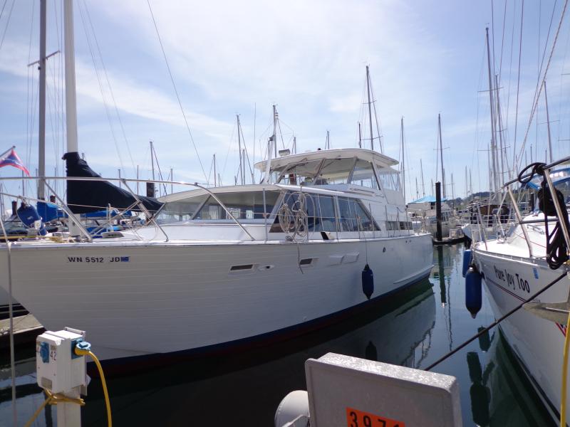

    I bought a 1965 tri-cabin I haven't found a official name for it. I have seen a few pics on the web that call it a 38 constellation salon model. Although none show a hard top extending from the helm back like mine. It has a large salon with a galley in the back by the stairs from the helm, the stateroom down in the stern. And a small head and v-birth down in the bow. It has flat front windows forward and large windows on each side of the salon with a small sliding door on the starboard side. Two gas 383s center. If I look up the Connie's, they all have the pointed front seat ahead of the salon on te bow deck and a separate galley/seating dinette. Please help with any info! Mike

    If you can post a photo (check the guidelines for this site before posting) we can probably help you out with identification.

    my chris craft, what is it?
    well i hope this works, first trip on boat and wheels 018.jpg first trip on boat and wheels 018.jpg
  5. SeaEric
    SeaEric YF Historian
    Jan 28, 2007
    1,385
    out on the dock
    She does indeed look like a model that was called a Salon. I'll look in my Chris Craft Essential Guide book tomorrow when I get to my office. In the meantime, look at a website: chriscraftclassic dot com. I think she is the same or similar model to your boat.

    It is somewhat like mine. However my Chris continues aft at the bridge to the rear bedroom wall,his has just a raised"doghouse" where mine is enclosed with a hardtop and is level. You step down from helm to a level rectangular salon that has the galley at the aft wall,level, a step down to the forward head and v-berth. Three steps down aft of salon to the stateroom and shower head. On no Chris craft web site have I seen one!. I'm the third owner. A Chris craft club mme mber here in anacortes,wa. Said it may have been a limited salon " one off" custom job made requested during the building of her. If you can go to Facebook under the name mike McDonough, I have a video of her inside and out. Thanks for all the help!!

    It does look like it is a "salon" model according to the original wiring diagram I found in the owners manual. The serial number is cbb 380008 or something close to that(bad memory!). I just haven't seen any with the hard top like mine.
